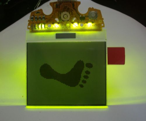

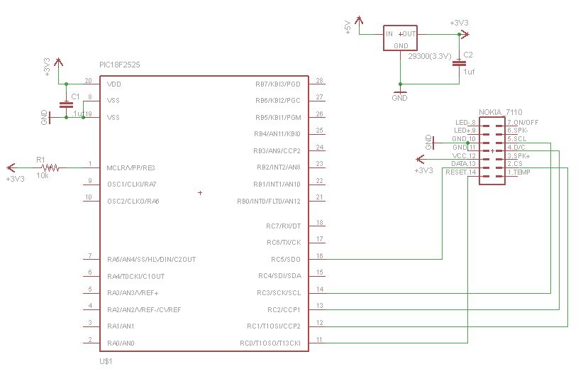

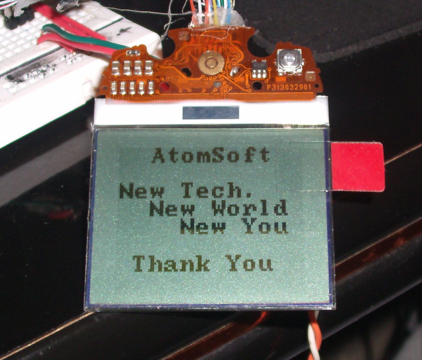

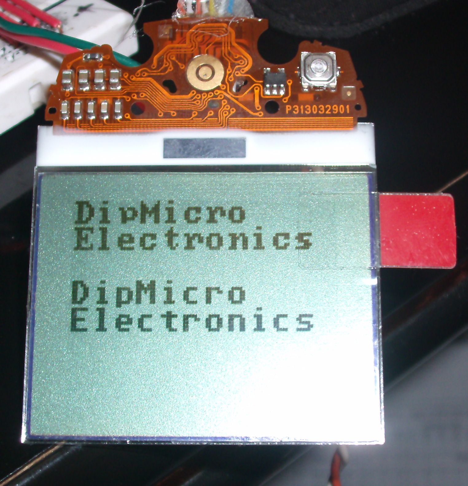

Here is my code for this Nokia 7110 LCD. I also have some pictures of it.
Code is in C18.

	#define LCDt	TRISC
	#define LCD		PORTC
	#define RST		LATCbits.LATC0
	#define CS		LATCbits.LATC1
	#define DC		LATCbits.LATC2
	#define SCL		LATCbits.LATC3
	#define SDO		LATCbits.LATC5

The 2 images below are:
1: the above code running with 1 font
2: the above code using both fonts to compare differences
Schematic coming soon!

I changed the function
void LCDString(rom unsigned char *str, unsigned char myFont);
//    to
void LCDString(rom unsigned char *str, unsigned char myFont, unsigned char fade, unsigned char typed);
and modded the code its nice. Ill make a video tomorrow. Too late here lol

Here it is... I made this with it in seconds:
foot-jpg.29563
Oops forgot to add the new code which include drawing the images. Here is the up to date C file.
EDIT:
New Program update and code. Now it creates the Variable with the HEIGHT and WIDTH in it so you dont have to enter it.
You would show or draw a image like:
// void LCDImage(rom unsigned char *image,char left, char top);
LCDImage(box,0,0);        //would black your box image in the top left corner
