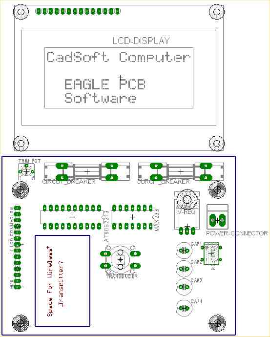

Here is a pic of the board layout I am working on.
Ok here comes some the questions... feel free to jump in anytime.
1: Desired effect: Device can run upto 4 hours AFTER main power supply is shut off.
Therory: Just add enough caps (Size and Voltage to be determined after power need and drain is determined) inline after Vreg.
2: Desired effect: Take one varitable voltage input and have it processed by the Micro to give 4 independent answers.
In regards to the micro, would an AT90S2313 do the job? Or would an Atmega 128/256 be better?
Does a trim pot need to be inserted to calibrate signal from transducer or can this be done via Micro's code?
Can I get the Atmel to process 4 requests?
You can use a pot to calibrate the transducer directly (maybe, depending on the transducer).
You could also just do it from purely from code using hard-programmed adjustment factors or constants, or use a button that lets the microcontroller know the current pressure being measured is X pressure so it can calibrate around that (if you are able to apply a known pressure in the first place), or use the pot as a voltage divider to feed the microcontroller's ADC a variable voltage to calibrate it that way- not a direct calibration, but more of a "you're off by this much" signal to the microcontroller so it can digitally adjust for it.

I would use the micro to make all adjustments and calibrations. Prior to loading the truck push a button to have the computer record your empty weight. That will account for whatever non load weight you have added. It will also take care of drift (if any) in the system.
In regards to what processor to use. Unless I missed somthing there is no great need for speed with this system. The AT90S2313 only has 2K of flash. It could work but I would be more comfortable with more memory. Use a chip with at least as many analog inputs as you need. uC's are inexpensive, spend an extra $5 and buy youself some headroom.
dknguyen: Thank You for the tip on XBEE. They will do the trick quite nicely I believe. With a footprint that small and an operating range of-40C to 85C it should be robust enough. Put it this way... Below -5C or above 35C, I'm not going outside to work.
3v0: Good suggestion. After several hours last night of looking at what was available I have determined that the ATmega128 or 256 will be sufficent.

You might want to consider a digital output transducer. That would simplify your interface to the uC.
