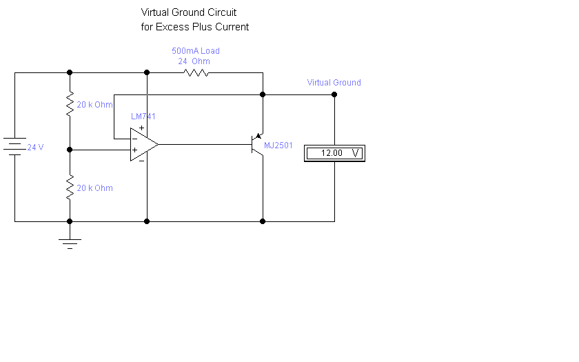

You could use an active circuit to generate the virtual ground at 12V but it would be wasting 6W of power, which the virtual ground circuit would have to dissipate . Here is an article on virtual grounds.
You would need a high power buffered design. Attached is a circuit using an op amp and a MJ2501 PNP darlington power transistor or similar, which must be on a good sized heat sink. You only need one transistor since your circuit is unbalanced with an excess of plus current that needs to be routed to the negative side.
(Note: Do not connect the 24 ohm resistor. That is just to simulate the 500mA load you have.)

really thank u so much the article so helpful and the circuit nice too i think i'll do it just what do u think about this thought **broken link removed**

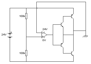

Here's another virtual earth circuit.

Due to the added high gain of the two common emitter output stages in cascade, without compensation that circuit may exhibit instability or oscillations.
What do you mean? The output stage is a follower.
The booster transistors have no voltage gain so no, that won't happen.
I decided to opt for a Sziklai pair, rather than a Darlington because there's less dead band so the op-amp's output won't have to jump so much.
I did forget to put a decoupling capacitors from the virtual ground to either supply rails though.
Your are right of course. I just looked at it wrong.
That's understandable, it does look confusing at first glance.
Another thought :the good thing about using transistors like this, is it's really easy to do current limiting, if required - just add a couple of sense resistors and another pair of transistors, I'll post a schematic if the OP wants me to but it's probably obvious to you.
