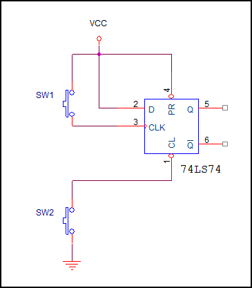

If you want to use two switches and a D flip flop you should be able to configure it like the attached. As each switch is pressed the outputs will toggle. Was that what you had in mind using 2 switches? Depending on what you do be careful of switch bounce issues.
Ron
To modify Reloadron's suggestion, if you can ground the switch inputs, then just run them to the set and reset inputs of the FF (since the set and reset FF inputs are usually active low). You don't need a clock or worry about switch bounce. Just use a pull-up resistor (say 10k) from each switch output to the +5V supply. Connect the D and Clock inputs to ground.

I finally got the components and tried out the various configurations on a JK flip flop. I had a lot of trouble with predictability using the microswitches as whether they toggled or not seemed to depend entirely on how the switches were clicked, though this was probably because of the delay issue crutschow mentioned (didn't have a delay chip).
However, more by chance than anything I stumbled upon the fact that for whatever reason putting the microswitches between ground and set and reset pins worked perfectly. I guess when the switches are open the pins are considered high or something, because otherwise it makes no sense at all to me!

That's the circuit I mentioned in my previous post.
TTL inputs will appear high when open. But for best operation and maximum noise immunity, you should add 10k pull-up resistors from each input to +5V.
You probably are having switch bounce issues.Read this paper.

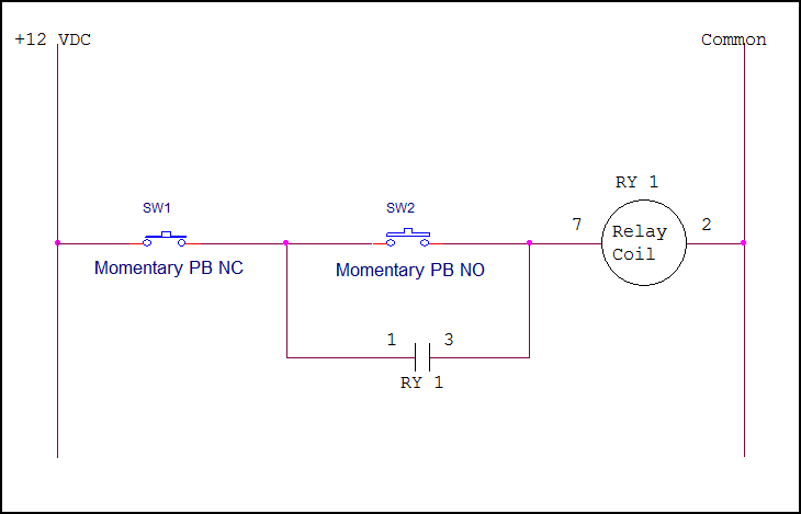

I think your next logical step is to select your relay(s) based on the load(s) you plan to have them switching. Once the current the relay contacts will need to switch is known then a relay can be selected and the needed coil current known.
However, there is a caveat here. Back to the beginning the object was to toggle the output of a flip flop using a pair of micro switches. I think that has pretty much been nailed down. You have your switches and the flip flop is ... well flip flopping. Now that flip flop action will be used to toggle a relay or relays on and off.
Now this gets me to wondering. If I want to use a momentary switch to latch a relay on and another momentary switch to turn a relay off I generally use a simple circuit like the attached. The relay used in this example is one of these using an 8 pin configuration. They also come in 11 pin configurations depending on how many contacts you want. The idea here is pressing the NO push button (or NO contacts of a micro switch) will energize the relay closing the NO contacts of pins 1 & 3. That action will Latch the relay on. The relay will remain latched on until power is removed by pressing the NC push button (or NC contacts of a micro switch).
Depending on the relay that could leave another full pair of SPDT contacts for loads or other applications. Nice is that my relay coils can be AC or DC in a variety of voltages. I don't need extra parts to regulate voltages or transistor drivers for relay coils.
I am not trying to disuade learning logic and driving relays but wanted to point out another approach to latching a relay.
Ron
Switch bounce is not a problem when using the set and reset FF inputs, as he is now doing.
Oh, I was not clear on what circuit was used. In one of the above shown circuits, the switch was connected to the clock pin.
