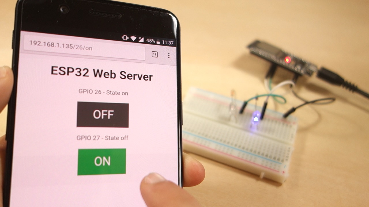

There are plenty of options, but without available WiFi you would need a GPRS system instead - so a SIM card and subscription for the connection.
Obvious issues are the power requirements, as it needs to be permanently powered up if you want fast access to it, and the cost of the data connection.
For an example of how it can be done, using WiFi at home have a look at:

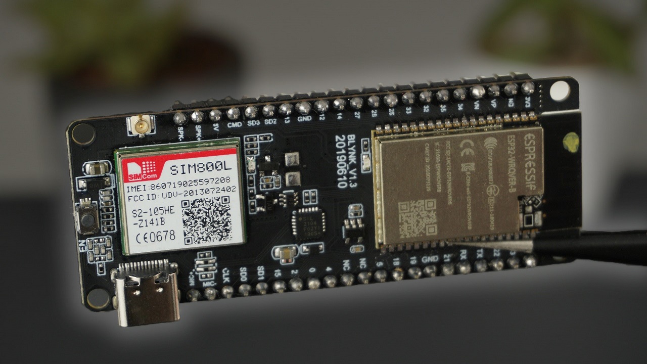

There is also an ESP32 variant with a GSM Modem, but bear in mind it's 2G only.

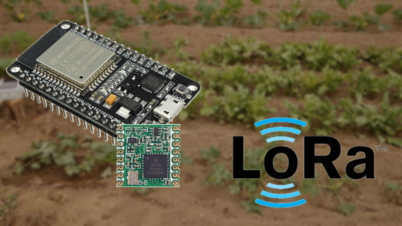

How far away is the field?, does it only need to be accessed from the farmhouse?, does it need to be accessible from anywhere?. If it's only from the farmhouse, and that's not too far away, there may be easier options - such as LoRa
