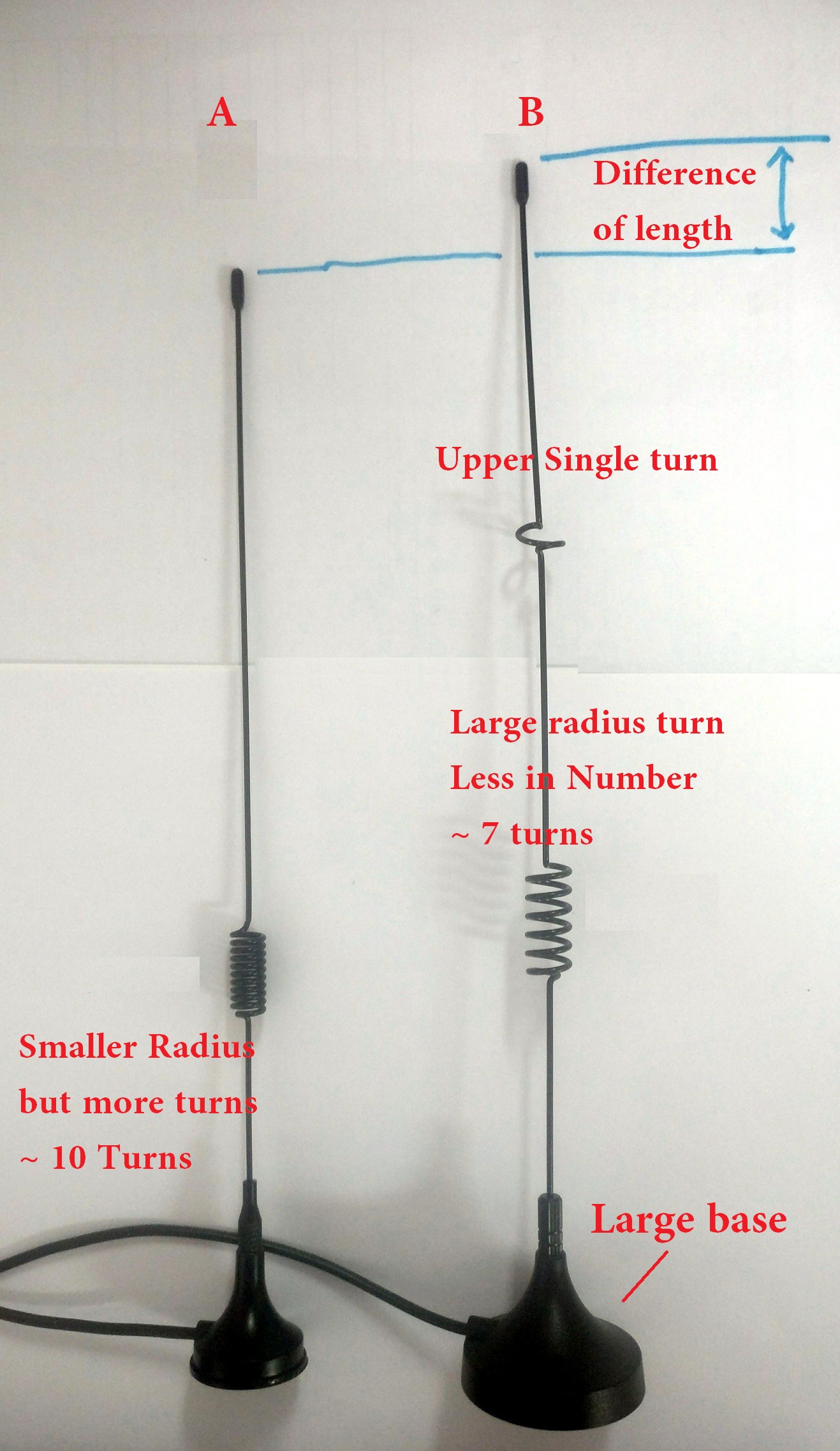

The left antenna (A) has:
1. Smaller in height.
2. More number of small radius turns
3. Small base (magnetic mount)
The right antenna (B) has:
1. More height
2. Less number of turns which larger radius comapared to A.
3. Large base (magnetic mount)
4. Extra Single turn above multiple turns.
Q1: How can i determine the dB gain of antenna?
Q2: If there is no relevant measuring instrument available, can i choose the best among two just on mere physical dimensions?
Q3: What is the purpose of helix/spring in both the antenna?
Q4: What is use of extra helix in Antenna-B?
Measure it.
You will need:
a signal generator
a calibrated receiver or spectrum analyser
a suitable "antenna range"
Not easily.
Difficult to say without knowing the dimensions of the antennas and the frequencies involved.
Basically loading and phasing.
Who knows?
Looks good to the casual observer.
Adds another $5 to the price?
JimB answered those well :)
tho for #2 ... RF experience tells me B has more gain ( reason in answer #4)
just up from the base, loading, provides 3 common purposes
1) --- impedance matching to feedline
2) --- changes the radiation pattern of the antenna ... for base loading it aims the radiation pattern upwards
3) --- it can also be a phasing section between antenna sections
this is purely a phasing section
so there are 3 sections
a 1/4 wave below the main coil and either 2 x 1/2 or 5/8 sections above the main coil with the phasing loop between
this arrangement is pretty common for phased arrays
