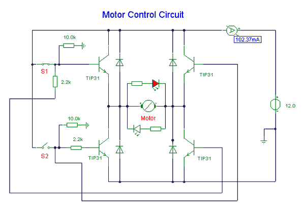

I used 4 transistors for the H-Bridge, those 2 2N3055 are for the driving the h-bridge from the basic stamp II and I used schematic from this site.
this is the circuit of the h-bridge, I used 2 2N3055 as switches
how are you going to ensure you have enough voltage to switch-on the top BJT's ? you are useing NPN's and no bootstrapped/floating gate supply
Logic level MOSFETs work much better. They have loads of gain, fewer components, and run much more efficiently & cooler.
Can you give mesome examples of Logic levels MOSFETs,
like part number or whatever, I'm going to do some researches also, thanks:)
Oznog wrote this earlier :)
Go to Digikey, search for MOSFET, and select "logic level". Try these from **broken link removed**
IRL520N N-ch MOSFET logic-level gate voltage, 10A, 100V TO-220 $0.67
IRL530N N-ch MOSFET logic-level gate voltage, 17A, 100V TO-220 $0.87
IRL540N N-ch MOSFET logic-level gate voltage, 36A, 100V TO-220 $1.17
