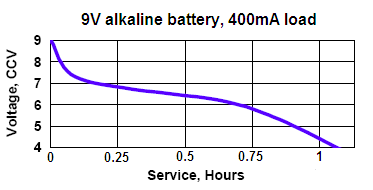

To address some questions: I cannot use more than 2 AA batteries to keep weight down. I can use any voltage to supply signal to the H bridge (i.e. 9v) so is it agreed that the L293 /298 it the best choice? Does anyone have a schematic for wiring this IC up?
The H-bridge ICs waste 5V so cannot use only 2V to 3V from two AA cells.
A little 9V battery cannot supply enough current for more than a minute so it also cannot be used.
You need to use the custom-made IC used in those tiny RC cars about 12 years ago. Then make a tiny robot that uses a low current.
The motor draws 150mA when it is idling with the gears disconnected, not when it is driving the robot.
Here is a 9V alkaline battery with a 400mA load:
