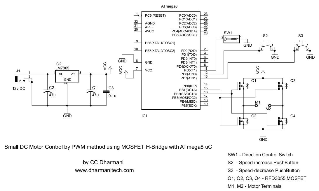

Thanks for your replies Andy, Boncuk, Stephen87. I'm already exposed at BJT transistors for h-bridges. I already used them on my previous projects. I'm not yet familiar if it's also using PnP or NPN types. I don't know if the same concept is applied on MOSFET dc motor drivers. Here's what I found. I've read that MOSFETs have internal diodes. He's using RFD3055. I have some questions.
1. Will this be fine even without external diodes?
2. If I can't find this type of mosfets on our local stores, what substitutions will I look for? Power MOSFETs?
3. What should I check also on the datasheet? Is it the current drain?
Thanks a lot. :)

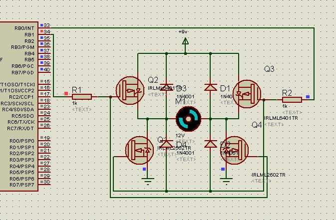

The Mosfet H-bridge will not work
1) The Mosfets selected need 10V between the gate and source to properly turn on. The lower Mosfets get only 5V.
2) The upper Mosfets get nothing because for the source to be pulled up to +5V then the gate must be +15V which is impossible.
Usually P-channel Mosfets are used for the upper mosfets so that they turn on when the gate goes to ground.
All Mosfets must be the 'logic-level" type that properly turn on when the gate-source voltage is only 5V (ordinary Mosfets need 10V).
You Must have the diodes to protect the Mosfets from back EMF from the motor. Andy

Anyway, I tried creating this MOSFET h-bridge based from the basic schematics. I can see it turning on with my PIC.

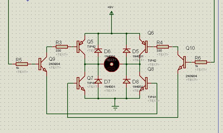

I've also made another alternative H-bridge made from BJT but with higher current ratings.. Hope to see your feedbacks.. Thank you very much :)
1) Your motor draws 10A to 22A but the power transistors you selected have a max allowed current of only 6A.
2) Your 330 ohm resistors provide a base current to the power transistors of less than 14mA but the datasheet for the power transistors shows a base current of 600mA for only 6A output. The little 2N3904 transistors cannot provide 600mA if the resistor value is reduced.
3) The datasheet for the output transistors shows that when they have a base current of 600mA and an output current of only 6A then their saturation voltage loss is 1.5V each for a total loss of 3V. The low voltage might stall the motors when you try to start them.
Post a video of the overloaded transistors blowing up.
I guess it will take more time to get your circuit working than shipping time will take for a functioning unit.
Small items are normally transported via air-mail and don't take more than one week from Germany to the Phillipines.
I have received mail from Germany addressed to me living in Thailand within four days.
Forget about your under-powered circuit and stick to a ready-to-go design.
