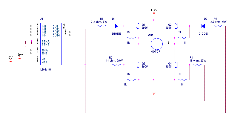

I am building a CNC router. I have the whole thing essentially done, except the control of power to the motors. To this end, I am trying to build H-bridges, which I have never done before. I acquired some MJE3055T power transistors, and I've looked at the basic literature. I constructed the standard H-bridge, but it isn't working. Many of the schematics I've seen for power H-bridges have both PNP and NPN transistors in them. Is this a requirement? The data sheet says that the gain should be between 5 and 100. A few that I have are around 250. Does the gain have to match all around? Is the low gain going to be a problem? I tried to use a single transistor to turn on a motor. When I arc the base to positive, the motor will run when it is below the transistor, but not above it. I am so close to finishing this. I am short on time and money, and this is to supplement the family income. Please help.

I tried uploading a pic of the circuit I am working with - take a look in my profile if you are curious. Looks like I was too hasty in my choice of transistor. I have to pull 10.5 amps peak very seldom, but nominally about 5 to 7 amps. My main concern is for the Z-axis of my machine. It's gonna draw a lot during a jog, pulling the Z carriage back up. I'm not really concerned about efficiency for this iteration, I'll worry about that next time around. Could I just drop a power resister in front of the positive of the H-bridge and be done with it, or is it more involved than that? What value would you suggest? Could I use the carbon rod out of an alkaline battery for the resistance?

Your schematic is horrible (please use real symbols next time) but it looks like you have the motor connected to the BASE on those two high-side drivers! They are probably destroyed now. Also never "arc the base to positive" without using a current limiting resistor on those low-side drivers or you will wreck them.

So, I have these duel H-bridge chips. Can I use them to drive the MJE3055Ts? They can handle 2 amps, 3 peak.
How far above the motor supply would I need to drive the bases?
Yeah, that looks like a good idea. I'm a little concerned about the PIV rating on the 3055's base with that approach. The base on your 3055 can only handle like -7V before it avalanches... but you could fix that with a diode, and it still looks like a smart way to do it because it gives you the logic level conversion and those important gates to lock out the "shoot through" state (very important! never trust a couple of port pins to do it).
Only a couple of volts (1.8V @ Ic = 4A), but there's a catch - the L298N drops a couple of volts, too, and the diode will add close to another volt, so Vs on the L298N needs to be a good +5V or more above the 12V rail to saturate those drivers. Plus you want a little over so you can put a dropping resistor in it. Say 20V.
The NPN on the top is going to get around -12V on it's base using the bridge, so you need a diode.
See attachment for what I'm suggesting. Notice the size of these dropping resistors on the base - two of them are 5W and the other two need to be 20W!

Thanks for drawing that up for me, duffy! I appreciate that! BTW, did you do this in Eagle CAD?

Dude! Your circuit works great! Only thing now is that my 298s went bad somehow. I got ahold of some TIP31Cs. I'm going to put them between the Arduino and the H-bridges.
