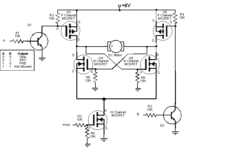

Hello,

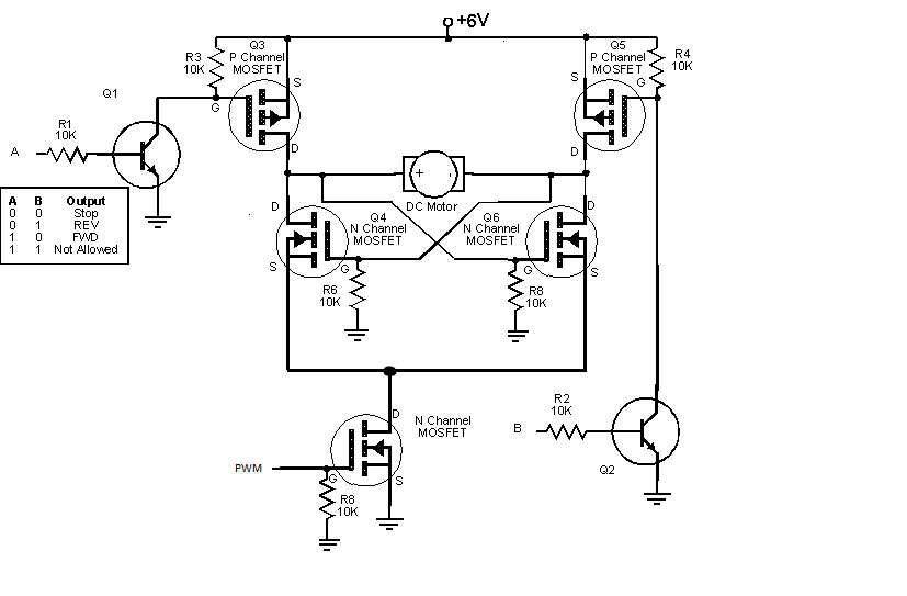

Im currently trying to use some existing design with eventual modification to make H-Bridge for controlling DC brushed motor with PWM. One bridge will control 1 DC motor. Bridge will have 3 inputs: A, B and PWM. A and B will be direction control while one PWM signal will control motor speed no matter in which direction it will spin.
Unfortunatly most designs i found are either used with bipolar transistors, they use mosfets but require 2 pwm signals or they are not usable with PWM.
I found very nice schematic of simple H-Bridge using Mosfet transistors **broken link removed** and its using 2 inputs A and B to control motor.
This is my modified version:
![mostekha.gif mostekha.gif](https://www.electro-tech-online.com/data/attachments/53/53047-8aa06a250b4a1a5ee61b7d39ba3caa94.jpg)
Will this circuit work (of course ill have to add protection diodes but first i want to know if it will work with PWM)? A and B will select direction of motor and no matter if it will spin clockwise or counterclockwise same one PWM signal will set its speed.
Transistors connected to A and B are 2n3904, P and N mosfets of bridge will be IRF7317 and mosfet with PWM will be IRF7905. Motor voltage is 6V and maximum current draw is 1.1A. PWM freq 1kHz
