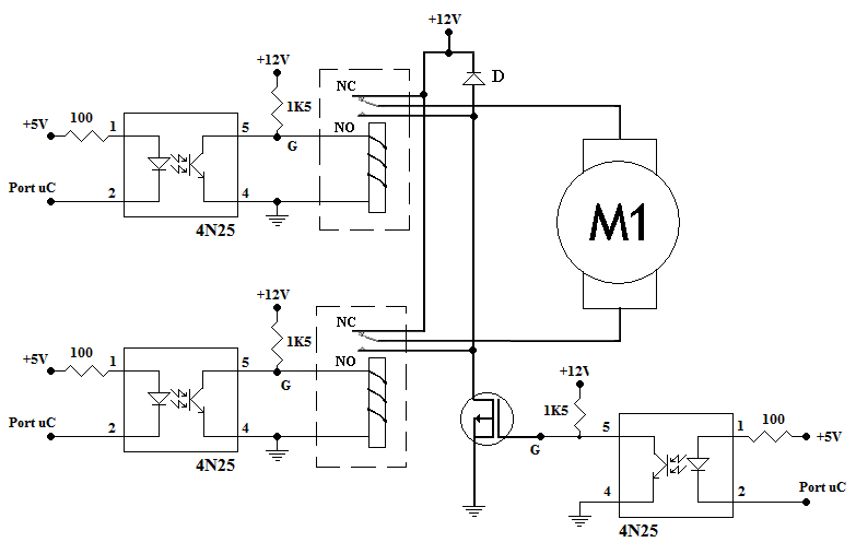

How I drive MOSFET IRF540 & IRF9540 on my H-Bridge circuit but it's control from PIN PWM (OC0) ATMEGA16??I've been try but the result just make the motor dc direction reverse and forward. :mad:

what i want is the driver not only reverse-forward but also can controlled the output voltage (in this case i controlled the speed).
For the PWM program for ATMEGA16 i've make and it work.
THe driver is probably an H-bridge (you can google for that one or search the forums). It lets you have forward/reverse for the motor. For speed control, you just PWM the inputs to the H-bridge.
If you are looking for something to drive the mosfets in the H-bridge with a signal from your microcontroller, I have used the LT1158. It seems pretty robust and can adequately drive paralleled mosfets for more power. There are other drivers available, but I like this one because it requires only a single PWM input to drive both top and bottom mosfets. In other words, you don't have to worry about programming a delay to avoid having both top and bottom conducting at the same time. John
Also consider looking at the H bridge MOSFET drivers from Intersil.
I've used a few from them and had very good results - they are also nice people to deal with and answer their emails promptly :)
PWM that control speed

ye....it work..........................:D :D :D :D :D
Thx for All....:)
dr123-png.17341
