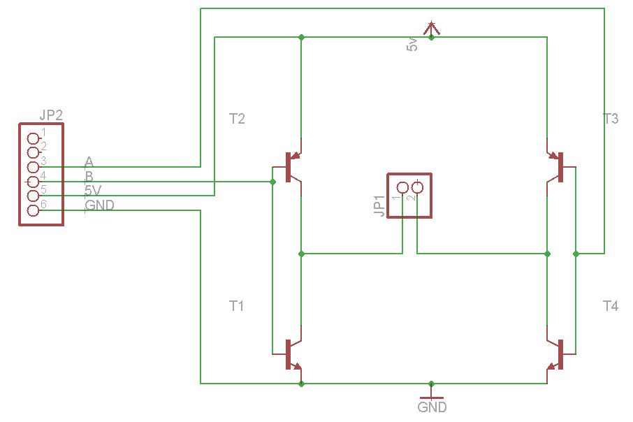

ok I tried making this but it doesnt work :( not sure why

but 12v

i used an opticoupler from four pic pins. used a 330ohm res on the bases of 2n2222/2n2907 (with pulup/puldwn res ), i also used shotkey diodes from gnd=motorout=pos. the motor i used is from the same as your project , it powered by 3.6v and has a stall of about 100ma.
Jason, what are R1 and R2 for? What voltage are you applying to the bases (A&B)?
I have one of those little motors lying here so just for the hell of it I ran it off a 12 volt battery (12.7 volts). Free running under no load it only draws about 35 mA and in a dead stall it gets up to about 800 to 900 mA. If you have a 2N2222 (NPN) and 2n2907 (PNP) they would likely work and I would use maybe 1 K base resistors to start if you are applying about 5 volts to the bases.
What you have is substantial overkill for what these little motors need.

How you have wired it it will create a short on the power rail. A should turn on T2 & T4. B should turn on T1 & T3.

Well - if you didn't burn out the transistors...
First off - you need base resistors on all the transistors - start with 1K resistors, that should be OK (there are ways to calculate what you need). You'll also want to add your diodes back in for back-EMF.
Now - you want to connect "A" to the upper-left PNP and the lower-right NPN, and "B" to the upper-right PNP and lower-left NPN. The way you have it set up, current won't flow thru the motor (and instead is shorting thru the transistors - which is BAD and called "shoot-thru") when activating A or B. You will also want to increase the voltage of the motor power source, as each transistor is dropping about a volt (leaving you with only 3 volts to go thru the motor - which is OK if the motor is a 3 volt motor, otherwise not).
Finally - depending on the current needs of the motor (not high likely) - you may need small heatsinks on the transistors (but I doubt it - those transistors are waaaay overkill for a small motor like you have)...
Whoops, I missed that.... :(
Ron
is connections A and B both high/low at the same time? that would make a differance as to the bases connections, as cr0sh stated i assumed the +/-

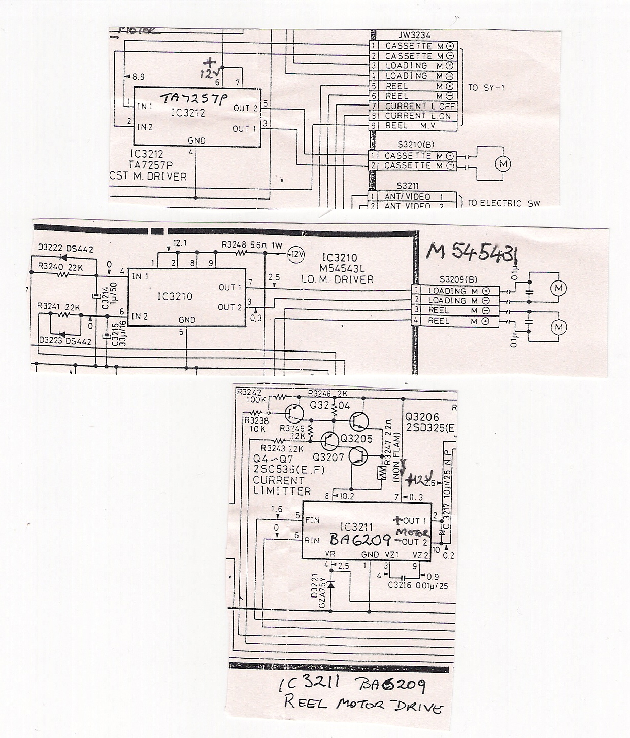

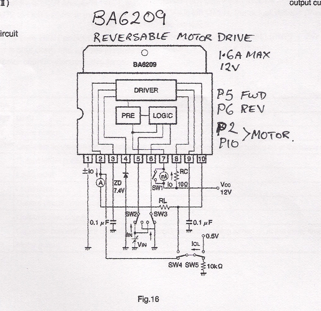

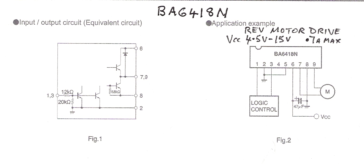

Why not go looking old VCRs theres plenty of free chips that will do what you want.
