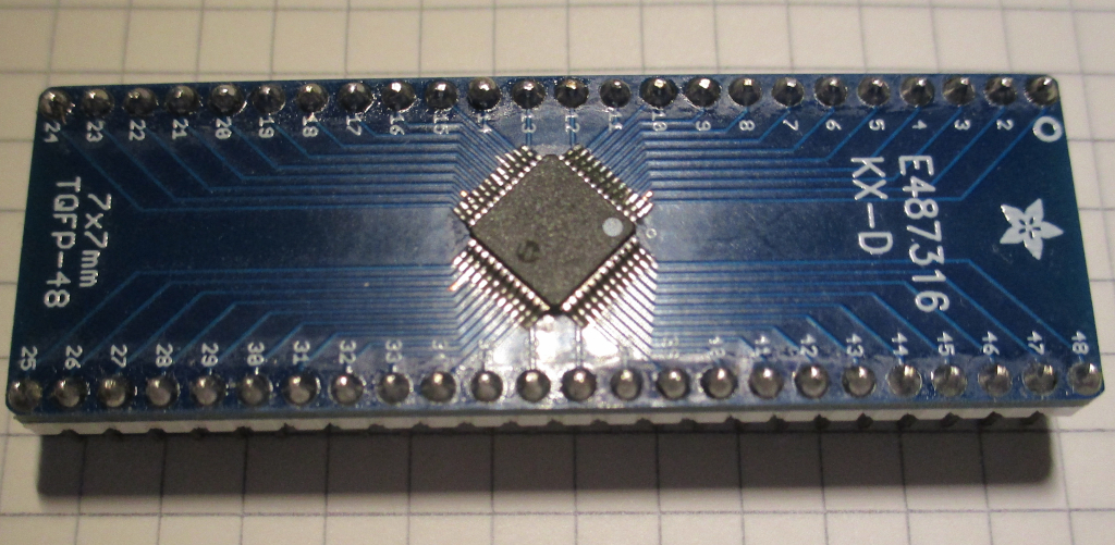

I managed to kill a PIC18F57Q43 IO pin. they don't like feeling 12.5v . was just the pin, would not sink anything so I had some smd TQFP 48 soldering experience.( If you need 5, 8 bit + a 4 bit port its a nice chip). IMG_1193s.jpg
I managed to kill a PIC18F57Q43 IO pin. they don't like feeling 12.5v . was just the pin, would not sink anything so I had some smd TQFP 48 soldering experience.( If you need 5, 8 bit + a 4 bit port its a nice chip).View attachment 147523
It was fed from the output of an opamp, used as a differential amplifier to monitor the battery charging current, they are rail to rail, fed from the same supply as the PIC.
