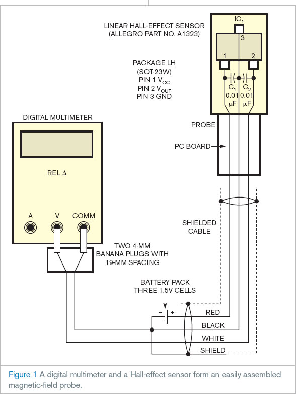

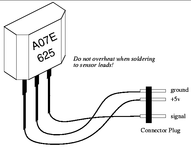

I have found two pictures illustrating the pinout from two types of hall censors. As you see, none of them use 12V as input voltage.

It being an automotive application I know that this is powered by 12v. Maybe there is something in the unit that moderates the voltage applied to less than this.
But what I need to ascertain is the function of each lead without blowing the device.
Vin
Ground
Signal
If I start playing around with it and apply any significant voltage to the signal lead , I risk burning it out, dont I?
