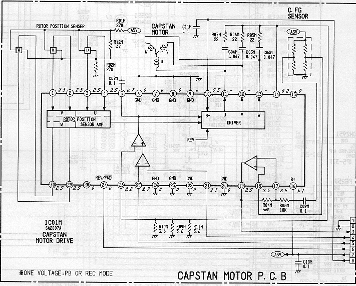

Hi nigel,
Thanks a lot for your info. on where to get hall effect switch from
junk floppy disc driver. I found three inside, but my problem is, it has four legs. I dont know where to connect the +,ground, and out wires which are common on three legged hall effect i.c.

Have a look at http://www.cybench.co.uk/salv/hall/hall2.htm, which might help you, although it only shows three pin ones. Try following the circuit on the old drive to see what goes where.
Hope this helps, I managed to find a circuit diagram for an old Hitachi VCR capstan motor - it shows the three 4 pin hall effect sensors. It looks like the outputs require feeding into a differential amplifier.
