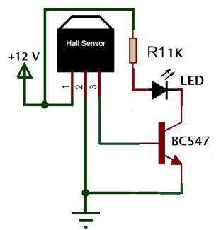

I found this circuit using 12vdc and considering the Hall Sensor output voltage is equal to operating voltage does the base of the transistor not require a resistor?
Depends on the Hall device characteristics. It may have some current-limiting feature internally.
Absolutely, yes!
As well as a series resistor to the base, I'd add a base-emitter resistor to ensuire any residual leakage does not cause problems.

Actually the A3144 output is open collector, giving a choice of 'operating voltage' and requiring a pull-up resistor.
So the BC547 in the post #1 pic would be redundant if the LED needed less than 25mA.

I slipped a 10k resistor onto the base of the transistor and it seems to be working fine through the transistor without the Hall sensor.
I don't see the need for the transistor when the Hall Sensor is the switch.
