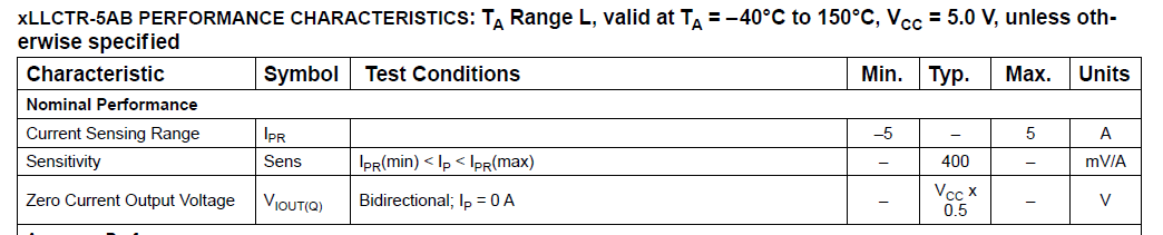

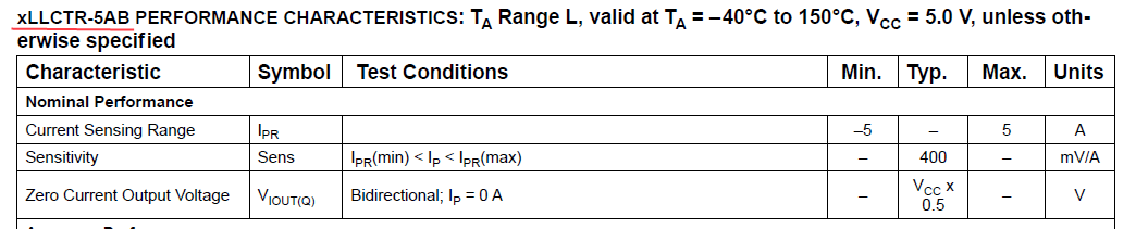

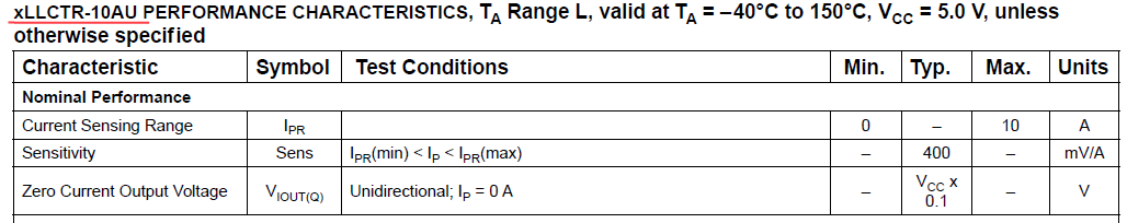

I bet you that it is not. Get a sample and measure it if you can´t comprehend the datasheet.....and it is surely simply the fact that the opamp cannot give an output at its low rail.

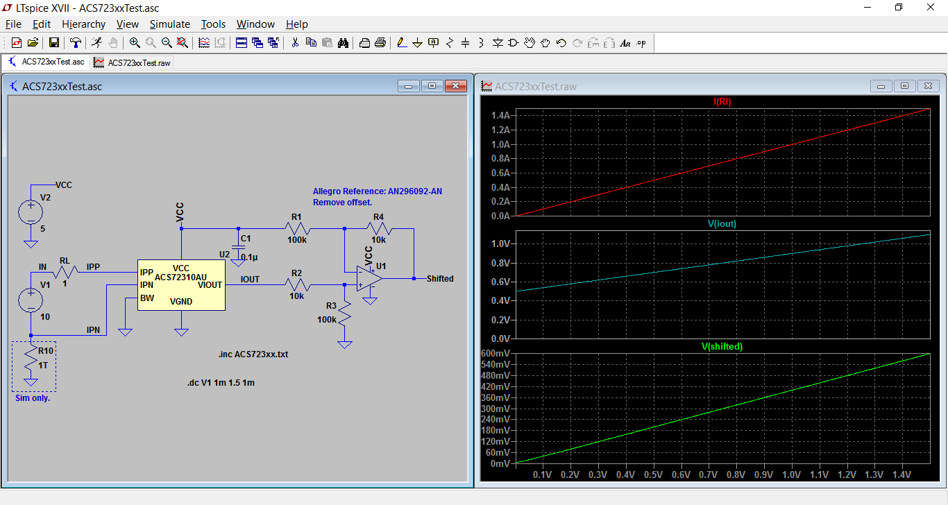

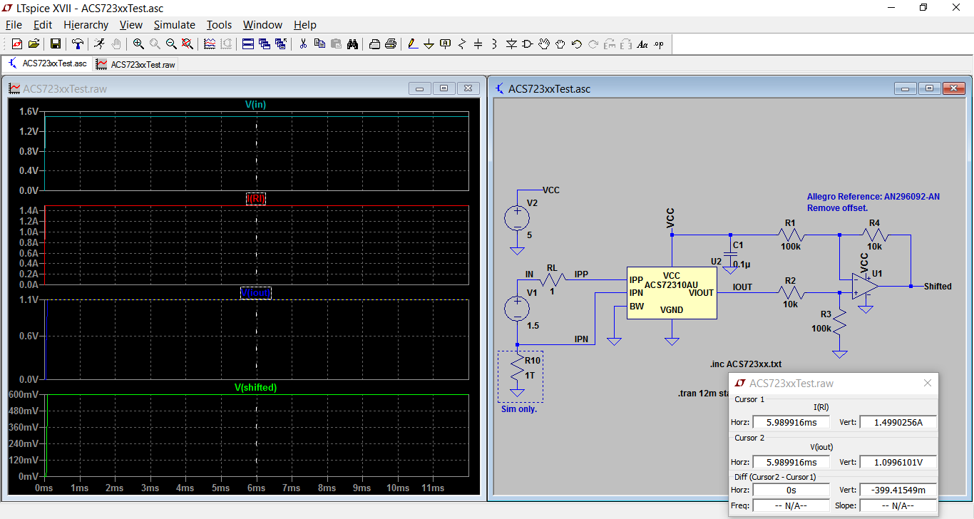

Thanks, it would be nice to see what you get when you ramp the current from 0 to 1.5.
I looked for a spice model of it but couldnt find it.
thanks, oh right, i thought you were simulating the ACS723 module provided by Allegro...so the one youre simulating is one you made for yourself, to behave as you believe it should behave?
I have learned much by:so the one youre simulating is one you made for yourself, to behave as you believe it should behave?
