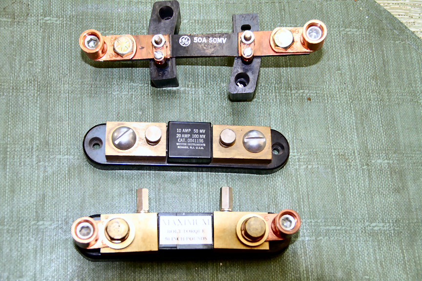

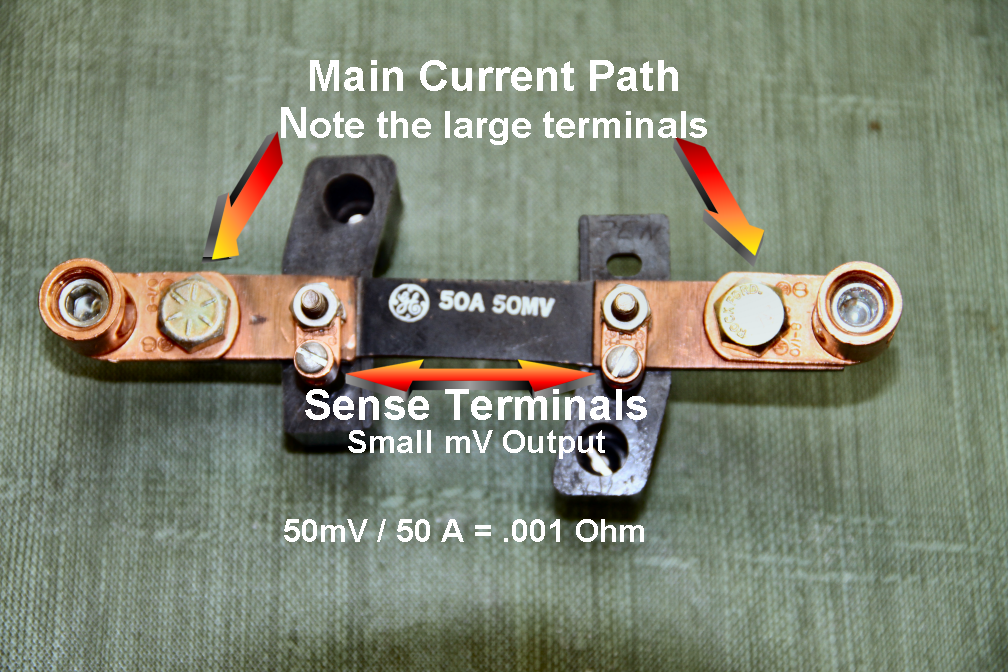

Attached are a few images depicting some standard everyday current shunts. Since you mention:
Why is that? isn't the 2.5A passing from Rshunt?
If we think about it the shunt has a resistance. We pass a current through that resistance to get a subsequent voltage drop and measure that drop. For example a 10 amp shunt like the one pictured in one of the images outputs 50mV at 10 amps. We can pretty much figure therefore that .050 Volt / 10 Amps = .005 Ohm. So the current shunt is 5mΩ between the shown voltage pick off terminals. When we pass a current through the resistance of the shunt we do not want it getting hot and the resistance changing.
Shunts are standardized to deliver either 50 millivolts or 100 millivolts at their full rated current,
although there are times when other millivolt ratings are desired or other physical sizes or
configurations are more suitable for an application.
Since the shunt is a resistor which operates in a varying ambient temperature environment and generates heat whenever current flows through it, we must design the shunt resistance portion with a special metal alloy which has, essentially, a constant resistance value through its operating range. In addition to using a precision resistance alloy with a negligible temperature coefficient of resistance, the alloy must have a low resistivity in order to keep the self-heating to a minimum, and it must also have a low thermal E.M.F. against copper. A special shunt manganin alloy meets all these criteria, therefore, all our shunts are designed using this special alloy.
The key word in all that is the alloy manganin and the above quote was taken from here.

What I attached was a few examples of actual current shunts merely to show you what some look like. Yes, absolutely you can use a resistor of your liking as Rshunt. Just remember most of what we have covered. You can't just shove any resistor in there.
