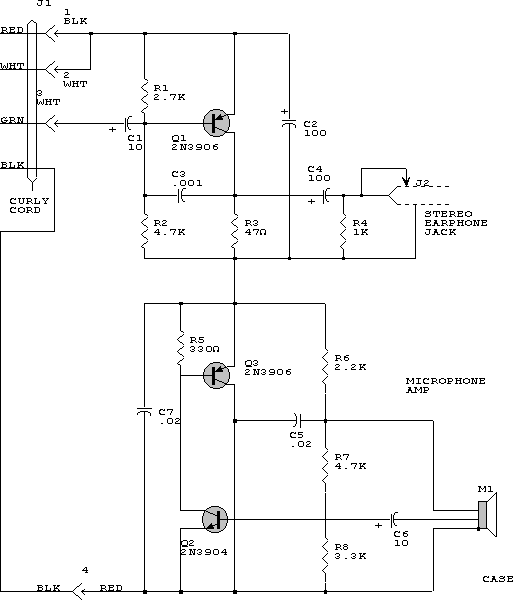

Actually i have assembled a circuit "Hands free telephone" ..with this circuit one can connect to a telephone instead of the hand set...
The circuit works, but it generates noise, the capacitor c3 i think is the culprit, iam using a polyester capacitor...
anyone plz help
