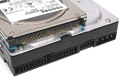

Hello , I have a hard disk which has one of its pins missed, so it can't be recognized by the PC and sometimes when I use a boot CD I had the following message:
"Windows can't be installed, because of there is no hard disk or the hard disk doesn't function properly,or it needs special software driver to get it work."
Sometimes the pc could boot at safe mode and as soon as it logged in windows, everything freezed so the icons and other windows standards doesn't appear.
Does the missed pin of that hard disk broke it so it won't work again?Or that would be of another reason?

if you are talking about 40-pin ATA connector, there is one pin that is missing on purpose - cable that goes there has that pin plugged so one doesn't turn it wrong way (rotate 180deg). it is close to the middle of the connector
yeah, I see in this image that there is one pin missing on purpose, it's in the middle at the bottom row of pins.There are two pins under the cable hole there , the second at the bottom doesn't exist and that's exactly what I had with my hard disk.
Am I right? or I might misunderstood your thought!
need more help please, with all my respect!
ok here it is (shamelessly ripped from seagate's website)
you can see the missing pin in the middle just opposite from notched cable key... some drives don't have either so one has to be really careful.
