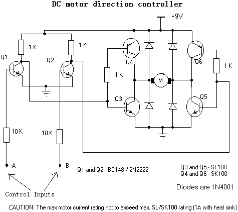

I need the SK100 and SL100 transistors to build the following circuit:
The problem is I cant find where to buy those. I look at RadioShack, they didnt have it. I looked through the DigiKey and Jameco catalog and they dont have it either..
What are some transistors that are equivalent to and can replace SK100 and SL100 and still make this circuit operational?
Thank you,
Steve
They are just used as switches, you can replace them with lot's of other types... How much current does your motor need?
Just for your information, that circuit has a flaw, Q4 and Q6 have no base current limiting.

Regarding the lack of base current limiting flaw for Q4 and Q6..
Would putting a resistor between Q4 and Q3 and another resistor between Q6 and Q5 fix that problem? If the resistor is the solution, does it matter what kind of resitor we put there (would 10 k-ohm work?)
Thank you,
Adding another couple of 1K resistors in series with the base of Q4 and Q6 will cure the problem.
There are other problems with the circuit as well, The SL and SK100 can only handle 0.5A, even tough the circuit claims to be able to handle 1A.
Also, the 1K base resistors only allow 9mA of base current - That's not enough to get the SL and SK100 saturated with 1A load...
Well, enough with my analyzing, can you get the TIP115 (Q4 and Q6) and the TIP110 (Q3 and Q5)? They're darlingtons with high gain, so they will get saturated with only 9mA base current.
you'll lose some voltage over the transistors, 2.5V or so, so you might want to raise your supply a bit (to 12V for example), in order to get 9V to the motor.

So you are saying that if I add two 1K resistors in series between the base of Q6 and Q4 that will fix the current saturation problem? How do you add the resistor in series between the bases of Q6 and Q4?
I was thinking of putting resistors between Q4 and Q3 & Q6 and Q5.
Maybe I am not understanding this correctly, I am not very good at this.
Here is a partial circuit diagram of that other full circuit with the resistor changes as I understand it....is this correct? If not, can you show me where I should place the resistors and how many resistors (the orientation of the transistors maybe incorrect in that image but I made that picture very quickly just to find out where the resistors should be placed):
Another rough draft image of the changes that need to be made to the circuit:
I will look for TIP115 and TIP110 transistors. I dont have them and the option of ordering from DigiKey is not possible at this time. I am going to look for them at an electronic parts outlet and Radio Shack tomorrow. If I cant find those, are there any more alternatives?
Other than these changes, does anything else need to be modified in this circuit? I know you mentioned some possible saturation issues, how would that be fixed?
Thank you
It will solve the fact that Q4 and Q6 have no base current limiting, look at the image below. The 2 resistors that were already there (above Q1 and Q2) limit the base current for Q3 and Q5, the 2 I've added limit it for Q4 and Q6.

Yes, but the Tip's are quite common, you should be able to get them...
By using the TIP115 and TIP110 this problem is cured automatically. They are darlington transistors with a much higher gain then normal transistors. Because of this they only need small base currents to be saturated (wich means 'turned on completely').
