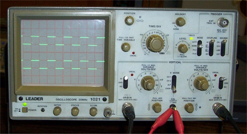

Please have a look at the picture. Is this a normal square wave? Is it what is expected from this oscilloscope?
From my very small knowledge, may I say that the voltage divisions is pretty well calibrated but the time division is a little off? Being a little off, I could adjust it with the time variable knob if I want to but really it is not such a big deal?

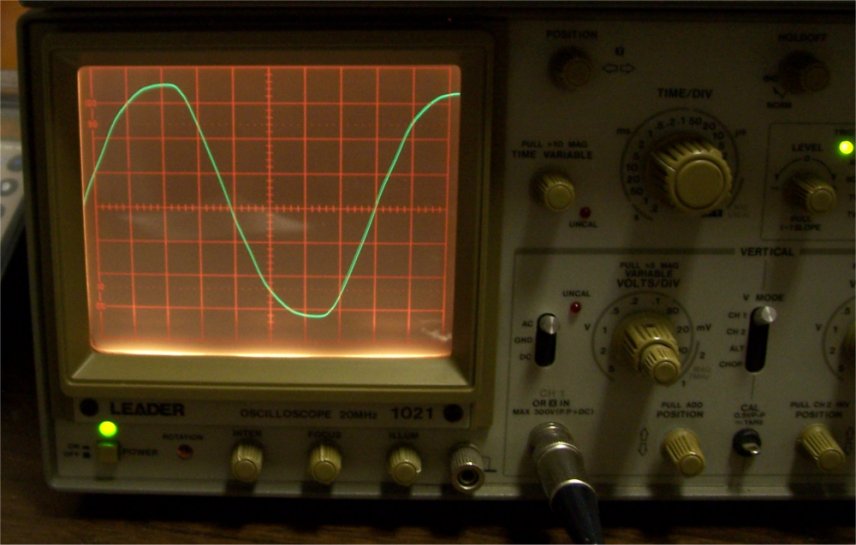

On the other picture it show a sine wave that I got from a computer sound card. Something wrong there?

It looks like a fine instrument. The "sine" wave might just be poorly synthesized by your sound card. I don't know much about sound cards, but I see tell-tell signs of a synthesized signal in your trace.
It looks like a fairly reasonable scope, certainly good enough for audio and low speed digital circuits e.g. 4MHz MCUs.
The square waveform looks right to me.
For frequency is better calibrated using a known stable source such as the mains frequency. There's no need to connect it to the mains though, just hold the probe in your hands and you should see a distorted 60Hz sinewave.
The sine wave from the the sound card looks pretty distorted, try turning the volume down.

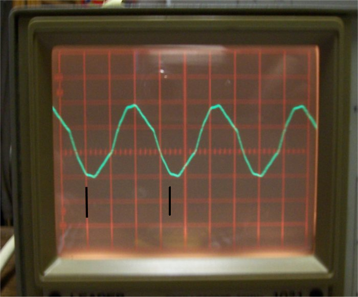

That was a nice tip! Look at my result! The oscilloscope is set at 5ms. Pretty decent isn't it?
It is flickering a lot at 5ms though. I had to use the Portrait setting on my camera to have the whole screen on the picture.

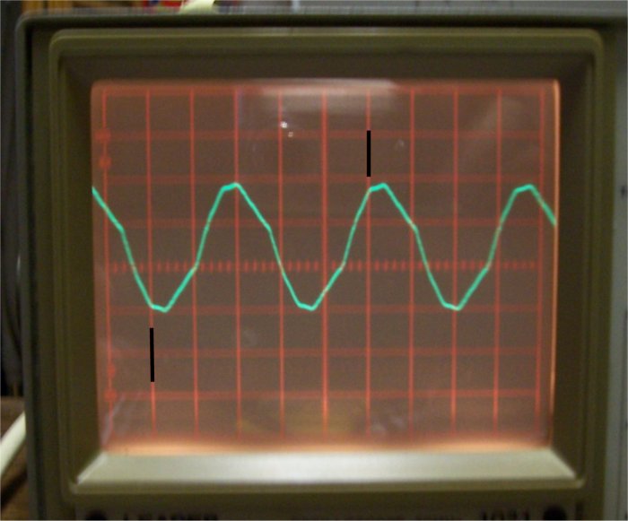

You've got 1½ cycles marked there.
Here's 1 cycle.
As you can see it comes to just under 17ms which is just about right.
The easiest way of doing it is by measuring three cycles which should be exactly 50ms.
You are looking at the ≈1kHz signal from the oscilloscope calibrate output. The ≈ symbol means that its frequency is approximately, not exactly 1kHz, so the oscilloscope time-base calibration is likely fine.
You're going to see "flicker" at sweep speeds slower than 1ms/DIV. If there's a front panel holdoff adjustment, it should be set at minimum for the least "flicker".
I see!
This little symbol was one of my interrogation. It look a little bit like a sine wave. But wy, was I asking myself, put what I thought was a sine wave symbol for a square wave output?

You're better off measuring three cycles which should be 50ms and calibrating if required.
