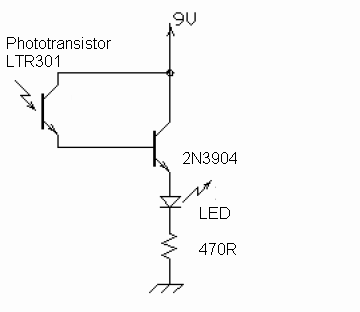

I just built an IR repeater yesterday and I was having trouble with the phototransistor.
This diagram I found may help you test the phototransistor or troubleshoot.
Good Luck

The following circuit will produce very little gain as the load is in the emitter and the transistor is classified as an emitter-follower.
If the load is placed in the collector, the LED will illuminate brighter and the circuit will be more sensitive.
remote-tester-gif.26541
