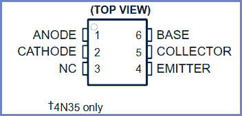

Look at the diagram of the 4N35 and see which pin is the base and emitter.
ya, i dloaded the data sheet just before i begin my work.

I just realized why the original circuit would not work with the 680 ohm resistor from base to ground. When the emitter voltage got to about 0.7V the transistor went into cutoff because the with the emitter + the base is effectively negative.
If the 680 ohm resistor on the base is connected between the base and the emitter it would always work. As an alternate remove the 680 resistor, as for normal switching it would not be needed anyway.
