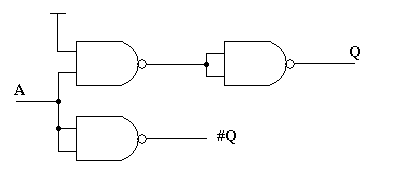

And you must control it with the NAND gates, you don't need to add a 2N2222.
Just configure the NAND gates the way that when you have a HIGH input, one optocoupler is driven HIGH and another LOW, and vice-versa.
Take a look:
When A = 0, then #Q = 1 and Q = 0
When A = 1, then #Q = 0 and Q = 1
A is where your signal comes from.
Then you know what you should do.
Still not right.

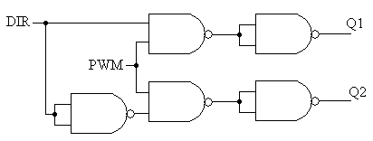

The A from my schematic is the direction. If you just connect PWM where it should be VCC it will malfunction.
You should add 2 more NAND gates to make some sort of MUX, with the Outputs and "PWM".
Then, in your power section, probably the MOSFETs gates capacitances will interfere your output waveform, you should drive them with push-pull or totem-pole drivers.
