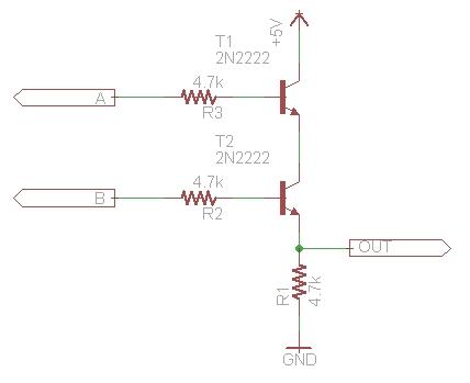

How do i make that AND gate? I never did small stuff like that before. Would it be like 2 transistors?

was just looking around and though id ask this here since its perfect spot heh... would this be a ok AND Gate???
An AND gate can be made with two diodes and a resistor to the positive supply at the output. The anodes of the diodes join at the resistor.
Each input is the cathode of a diode and if one is low then the output is low. If both inputs are high then the output is high.
