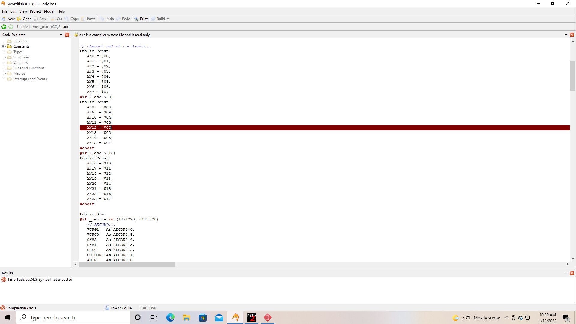

Have used this code before but it has a contemplation error, using Swordfish basic
I have no idea how it happened, but there's a missing comma in the file ADC.bas after the line 'AN11 =$0B'
#if (_adc > 8)
public const
   AN8  = $08,
   AN9  = $09,
   AN10 = $0A,
   AN11 = $0B,
   AN12 = $0C,
   AN13 = $0D,
   AN14 = $0E,
   AN15 = $0F
#endif
yes I saw that as well but It won't allow to be added?
Have several coppies of same file and all have same, missing comma.
I hope it has nothing to do with the free version of Swordfish and the purchased version. I had/have both.
going to try and copy n paste but the module won't let me even add the missing comma
Have several coppies of same file and all have same,missing comma.
Of course you do.
No, this is a mistake, and it's in both versions so you'll have to fix each one separately.
Files that are in the Library folder are protected from changes inside the IDE.
When you open ADC.bas you should see a message at the top of the editor window stating
"adc is a compiler system file and is read only". Double click on that line and it will allow you to edit the file.
Add the comma and save it back to where it came from.
Do the same in the paid-for and free versions
