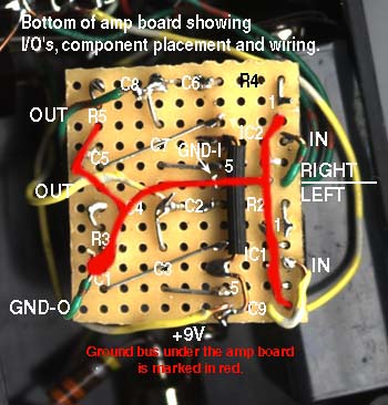

thx alot for that last link GENE, ive almost got it all done except for the grounding process. i read the grounding section in his main "headbanger" page but am still confused. according to me there are grounds on: r3,r5,c1,c5, pin 2 on both IC's, 100k pot, headphone plug and headphone jack, c9, c10, neg batt, and FINALLY DC NEG. do i just connect all of these together or what, i woujld appreciate any help on this, grounding has always been my problem.

Recommend you follow the section titled "Headbanger Grounding". There is a photo also that may help:
https://www.minidisc.org/ground.jpg
Grounding is critical for an amp. I mean, if ya gonna take the time to build the thing, you sure don't want to deal with distortion, hum, etc.
sadly, i did read the section on grounding and looked at the pic as well but am still kinda lost. First of all, where do both grounds end up in the end?, the -9v? and what goes connected to the ground 'lug', all of the input ground?
input: phoneplug, pin 2, pin 4, pot
output: R3, R5, headphone jack, dc neg, C10, C9
am i right on these?
Yes - you are right. The confusion may be because, electrically these points all connect . . . but, it is important WHERE they connect to a common bus (wire). Amplifiers and RF circuits are funny that way. I think that's why the author wrote an entire section on this topic - it IS confusing. He also suggested that you ground the case of the volume control. In a normal amp application this would happen automatically because the chassis would be metal. A long piece of skinned wire can be wrapped around the front of the pot before it is bolted down to get this done. Because of the number of photos and the length of the descriptions, I think you will do well. If you end up with a problem, perhaps there is someone in your community or a school science teacher that can give your project a first-hand look. Do not put the ICs in their sockets until you are finished soldering - they hate heat. Also, if you are not using the rechargeable battery, you can omit R6, C10, and C9.

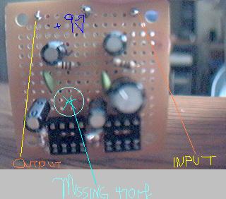

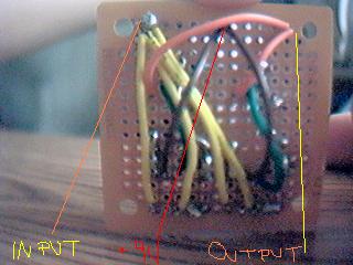

here are the pics of the main circuit board: Note the 470 UF is missing, (noticed i reversed its polarity, have to replace):
i separated the 2 separate grounds, would these then go to the -9v (not shown)? i have yet to connect the heaphone jack, pot(ordering it) headphone plug. (excluding batt charg)
thx alot for your help
ivan

I regret that I can't follow your wiring but I'll assume you have things under control. I sometimes make a photocopy of a schematic. Then, as I trace the connections with an ohmmeter, I highlight (yellow pen) the checked section on the schematic diagram. This is especially easy when there are no diodes/ICs installed. Something to do while you wait for your other parts to arrive. In the future you may want to use the componet leads or a smaller gauge wire for the hook-ups between components and consider using a vertical placement for resistors to save space. Lookin' good!
