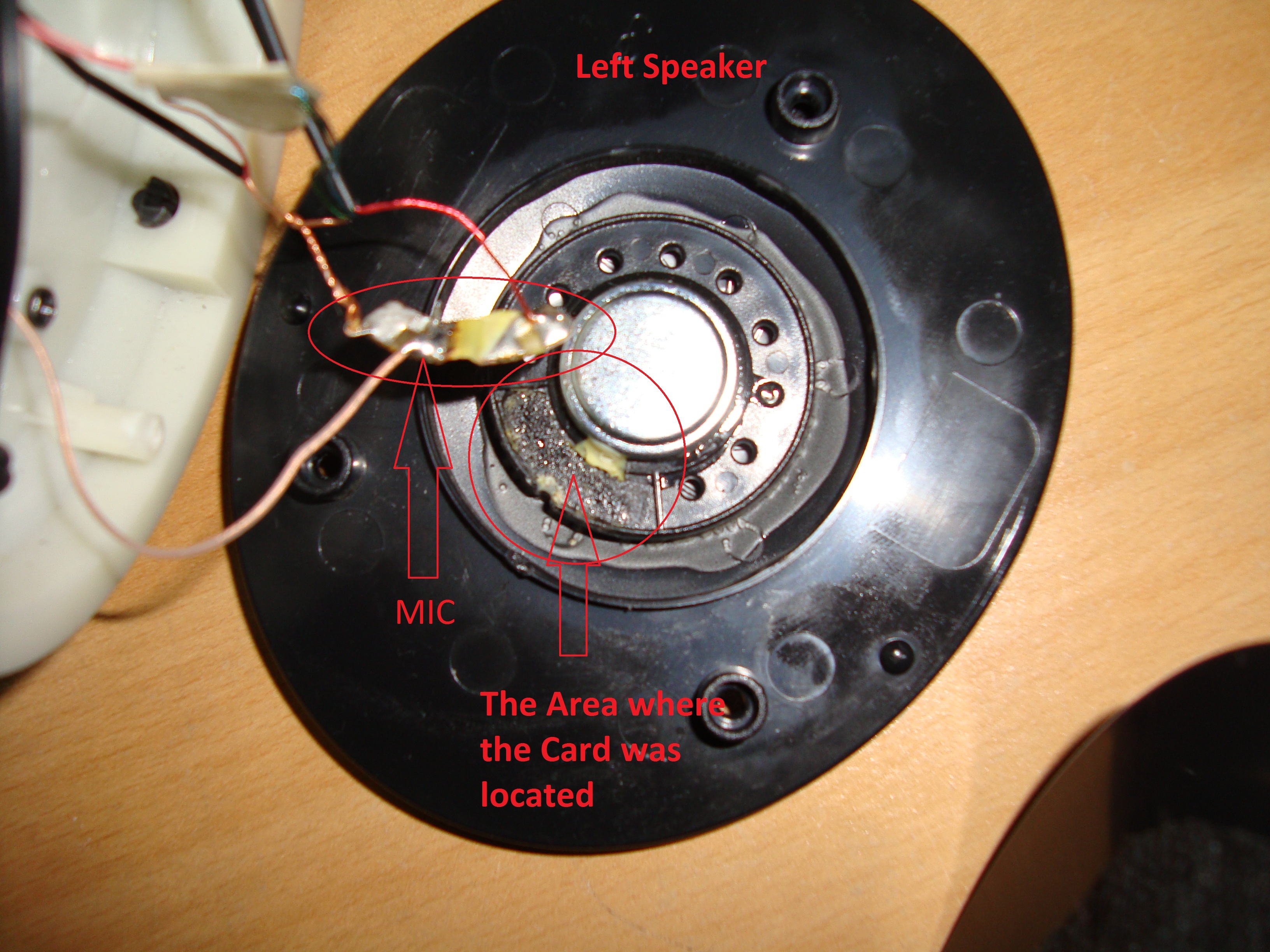

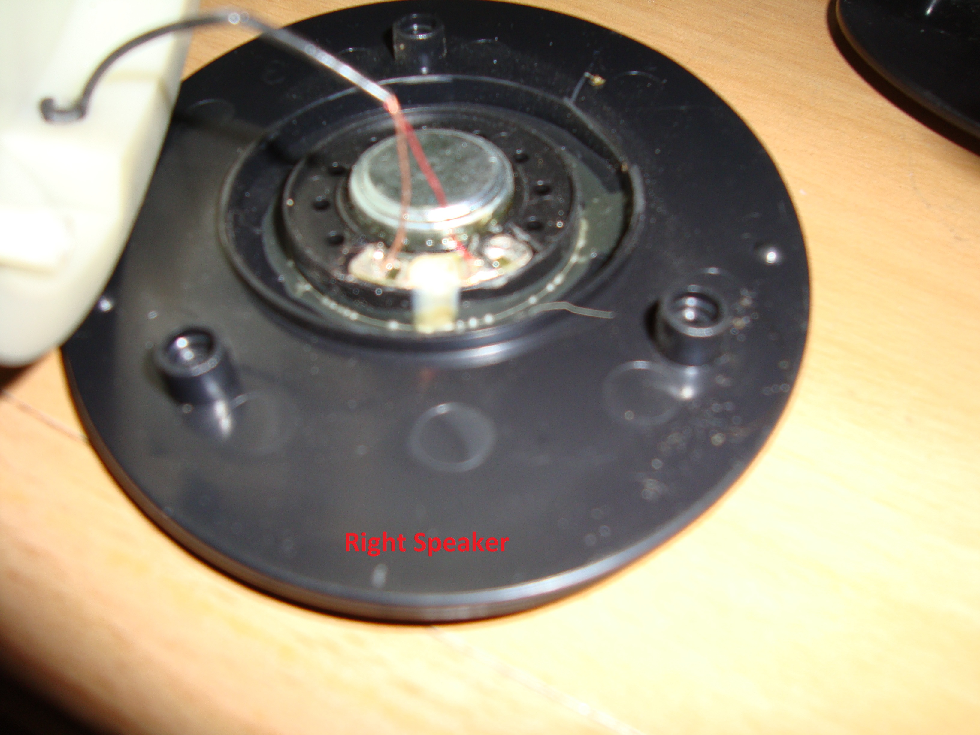

Once I found that my microphone is not working, I opened the headset and saw the mic wire came off the solder. Then i soldered back on its correct position but unfortunately a mistake has occurred during this process. The small card came out as shown in fig. I have taken a picture of right speaker to show how the left speaker would look like before.
And Thanks for any Help in Advance.

Hi"
Click the second pic at the bottom of this https://www.crutchfield.com/S-QKbzjg0B4OH/p_068R48N/Retrosound-R-48N.html page. It should show the back of a speaker.
What you have there is a "card" with two terminals on it. This particular one has 2 sets because it's a dual voice coil. This "card" should be mechanically fastened to the speaker.
Those terminals provide a transition from the outside world, then some very flexible wire and then the speaker's voice coil. The flex wire/voice coil connection is seen on the front of the speaker under some insulating material.
Your pics are a bit blurry.
There should be two very flexible wires attached to the speaker and also attached to the terminals of the "card". These could be broken which is what I expect. Look at the other one.
Then the headset wires attach to the card.
Your speaker should work with the "card" hanging.
If it does, you can glue it back in place.
Much better pic.
I can't see any wires either, but they have to be there or they got pulled out. You MIGHT see remnants on the "card". The drop of glue, may have secured them on the speaker side and they could look like a splinter in your hand. A tiny dot.

Those fine wires are taken to a fixed point on the speaker. The "card" in your case.
There is usually no slack in these wires as it would be perceived as a rattle. They just have to move the amount the cone moves without scraping anything. They are usually insulated with a varnish.
I'll bet the yellow/white glue is hot melt glue and the clear is polyurethane. To affix your "card", I's probably use contact cement.
Those "copper" wires are insulated with a very hard to strip varnish insulation. Scraping risks cutting the wire and the chemical stripper for Formvar is very hard to come by.
This https://forum.allaboutcircuits.com/showthread.php?t=29861 probably sums it up.
The suff is called "magnet wire". e.g, **broken link removed**. You might be able to salvage some from an old small transformer.
Repair will be EXTREMELY tricky.

Anything is going to be messy, High voltage corona dope might work.
