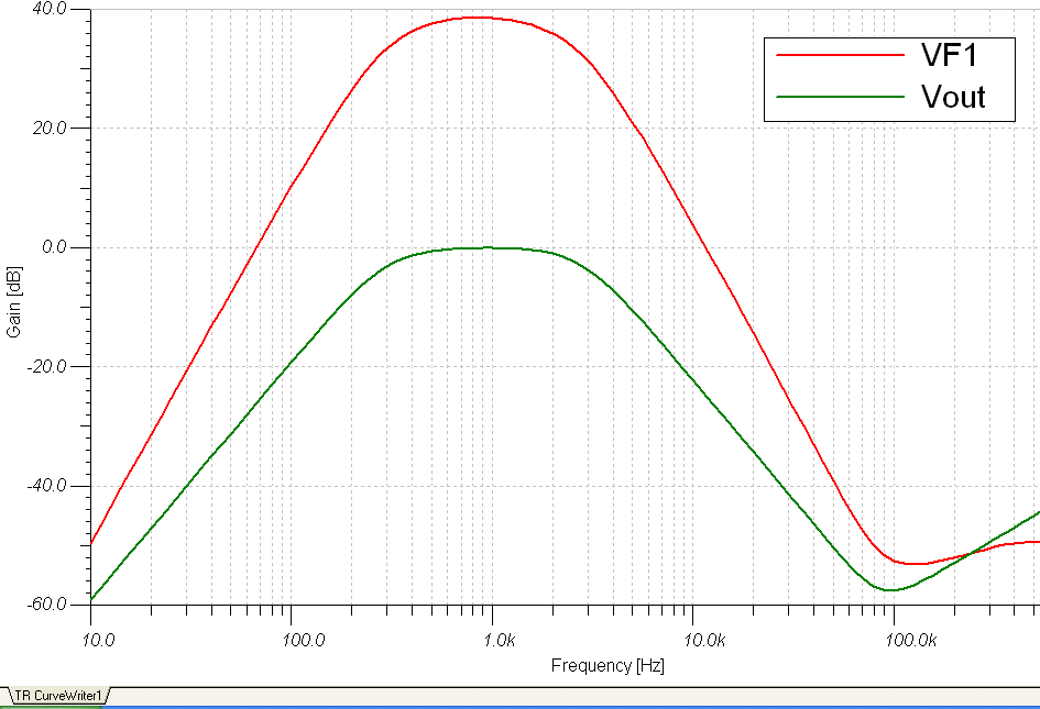

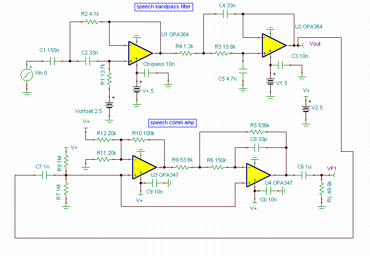

here is a speech filter and a speech communication amp.
Thinking about using a couple of ear buds for output to ears, several SMD mics for input.
Run on several AAA batteries.
BUT not to familiar with analog amps etc. do you think this schematic is feasible?
need to add a volume control and perhaps some SMD pots to adjust the filters?

If you know that your hearing loss is at a particular range of frequencies, then you could use a filter to amplify those frequencies (which is what the fancy digital aids do). Perhaps that, along with the speech filter, would be more effective.
thats why I was planning on using pots in place of set resistors so I could adjust as needed.
Not real up on amps etc but I Y O do you think the amp schematic I posted would be sufficient volume wise?

Why use a "speech filter" that cuts the very important consonants (s, t, p, th, f, etc) frequencies of speech?
Then mat and nap sound the same.
Then faucet and soffet sound the same.
Then choose and shoes sound the same.
Then faint and paint sound the same.
The difference between the words sailing and failing are in the frequencies from 4kHz to 14kHz.
Reverberation (echoes) and accents compounds the problem of trying to understand speech that has the high frequencies missing.
Without the important high frequencies, your brain gets tired trying to figure out what is being said.
My two cents.
I will accept your two cents.
Yea I know its in the mail
Good point on the high frequencies.
Perhaps extend the high end of the speech filter or add another filter that adds the higher frequencies then combine using a mixer circuit?
You need an equalizer that produces the same response as your hearing aids. Probably high frequency boost.
You must limit the amount of boost so that too much loudness does not destroy what remains of your hearing or causes feedback.
The amplifier will probably have a limited amount of "headroom" so that the battery can have a low voltage then either you must frequently fiddle with the volume control (to avoid clipping distortion) or have an automatic volume control circuit.
