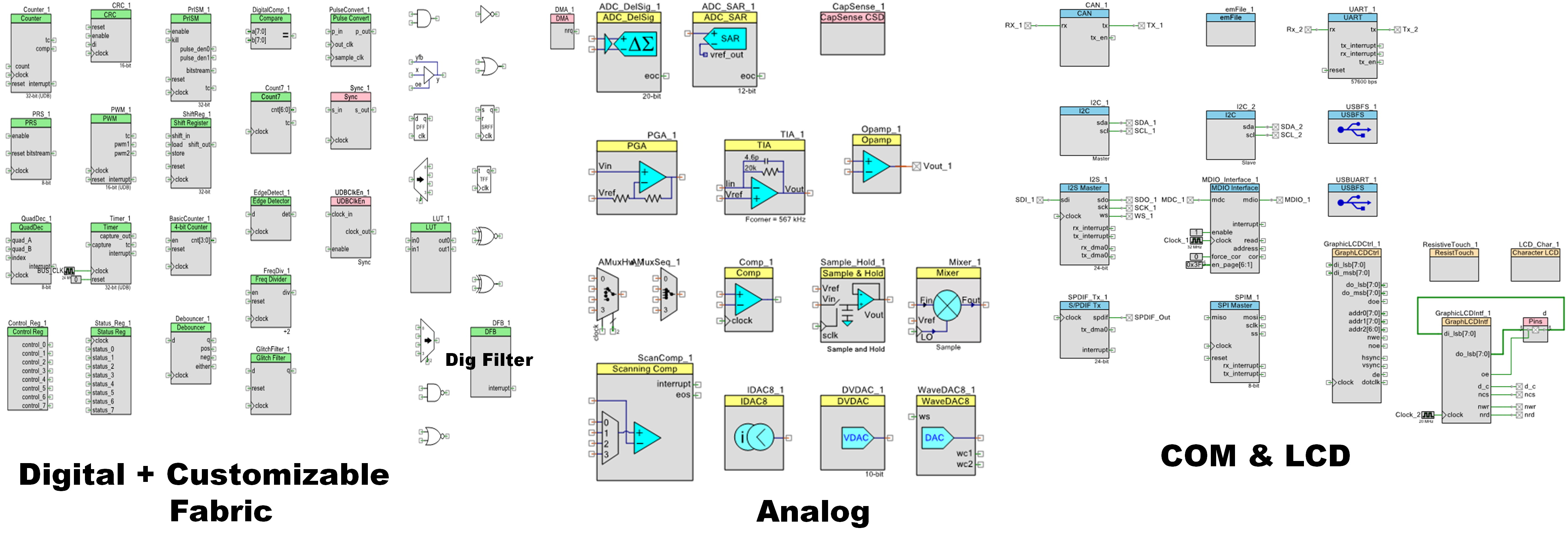

Single chip approach with SOC and onboard digital filter -
Note this ap note seems to have been obsoleted, maybe contact author to see
if there is an update. Could be medical application some vendors gun shy on
involvement.
In general, PSOC has the following on it (single chip) -
Regards, Dana
