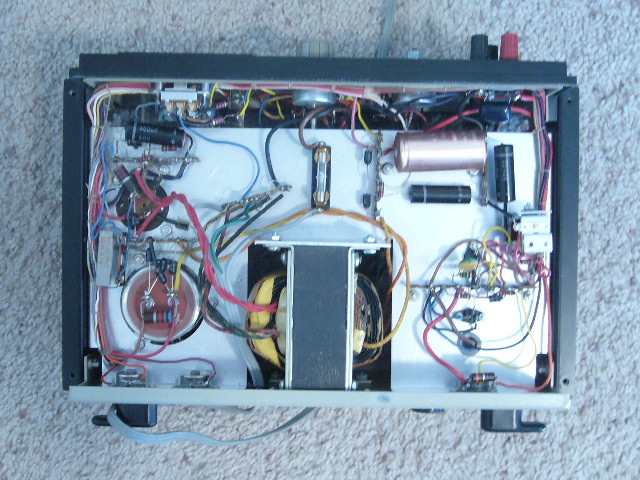

I'm fixing up an old Heathkit IP-27 power supply for a friend because it isn't working properly. At first It wasn't working at all, but when I took out the fuse and put it back in, it started working again (but not to its full potential). So It was a little dirty and needed some cleaning. Apparently, when you have a load you shouldn't get any voltage drop and the power supply will compensate for the loss voltage. So the voltage stays the same no matter the load. Unfortunately, this isn't happening and when I put a 100Ω resistor around 5V or so the voltage dropped significantly. My first guess is replacing the electrolytic caps since those don't last very long; but I might be wrong. How can I fix this? Here is the schematic because I couldn't find the whole manual online:

Does the black capacitor, white stripe, look normal? Is the right endcap of this capacitor convex in shape? .... Is there any sign of swelling, or discoloration?
Can't tell from the picture .... would appreciate a clarification.
Electrolytic capacitors seem to be statistically prevalent as the primary mode of failure on aging or older electronic assemblies.
Ok, I'm getting about 4mV of DC ripple on that bulky filtering cap at the bottom left-hand corner on the first picture. Is this ok? What would be a good value?
For that capacitor with the white band, all of them are like that. They seem to be painted on one side. They are rated 1000uF at 50V.

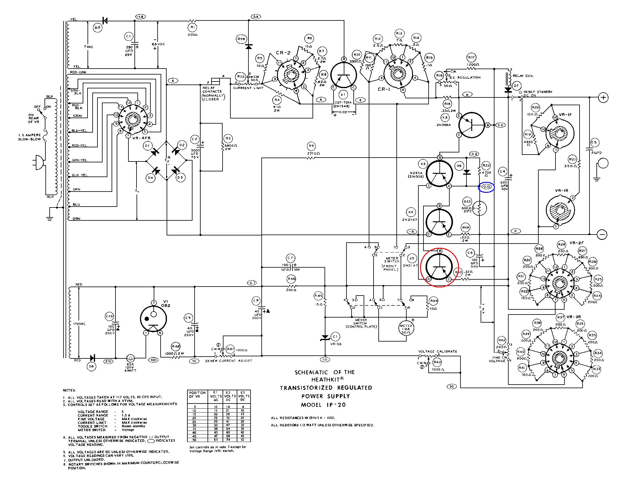

Do you guys see that grey wirewound resistor by the bulky filtering cap? Well that's supposed to be 2.5KΩ but it is actually 3KΩ. I'm thinking of replacing that.

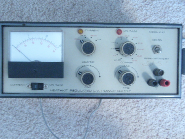

The meter doesn't work, it still says 10V with 5V output. The calibration is kind of funny too, when I spin that screw at the bottom of the meter it goes to zero where it should be, then if I keep going It will go up and then go back to zero.

Ok, I checked to make sure I was getting the Vbe drop and the transistor at the far right corner in the first pic seemed to be fried. The one above was measuring a 0.4V drop and the bad one below measured 12V! Does anyone know where I can find a substitute transistor in addition to the datasheets for this sucker? I'd appreciate it!

BTW: on the schematic, there is an actual part number listed under the part labeled R265A device which is: 2N1309
I can't find any transistor on the schematic labeled R256A, which is the number you list above.
EDIT TO ADD: the 2N1309 is a germanium power transistor. I don't even know if germanium transistors are still available?

I found the bad transistor, it is circled in red. I substituted a PNP power transistor for it and it worked fine, except that it's a silicon transistor and I need a gernamium one. Does anyone know of a substitute for it?
The transistor you circiled in red is wired in parallel with the one just above it in schematic. Those MUST be the same type of transistor or you will have serious problems because one will hog current and cook itself under load. Whatever transistor you installed in the red circle, put one in the above location as well.
