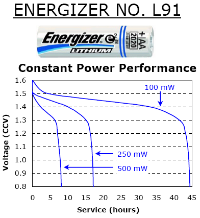

The new lithium AA cells have a very flat voltage over their long life. Their capacity far exceeds a little 9V battery or ordinary alkaline or even high-capacity rechargable Ni-MH AA cells. They have a max continuous current drain of 2A. They are fairly lightweight.
Check-out their 15 years "best-before" date!
Check-out their high price! I got some as a free sample for doing a survey about them and they keep going and going and going and ....

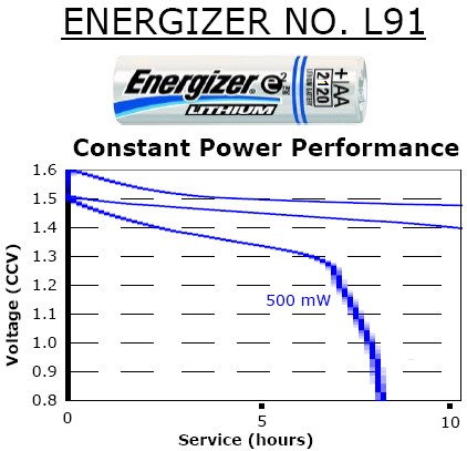

Just fooling around with MS Paint:
