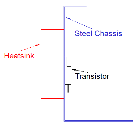

When mounting a heatsink to the Transistors of an amp say around 200W Max, Is it advisable to have the Transistors & thermal washers on one side of a sheetmetal chassis & the heatsink on the other side of the steel chassis?
So the chassis is sandwiched between the transistors & the heatsink--see attached drawing..
With it done this way how efficient is it compared to having the Transistors mounted directly to the heatsink.
Would it be better if the chassis was aluminium sheet?
Cheers

The thermal conductivity of steel is about 1/7th that of aluminum, and 1/10th that of copper. So it's pretty bad efficiency wise, you're effectively crippling your heatsink
The transistor should be mounted directly to the heatsink with only as much thermal compound in between them to avoid air gaps, if electrical isolation is required get isolated transistors or isolate the heatsink itself.
If the case is aluminum you're MUCH better off, probably much so because the case itself will supplement the heatsink.
I can guarantee you won't be dissipating 200 watts of power in a 200 watt amp, so you need to first figure out how much thermal energy is going to be produced, the temperature the transistor must be maintained at and the thermal constants of the heatsink itself.
True heat management is not easy.

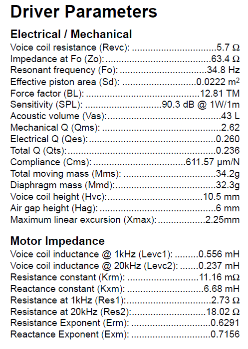

It's taken me a while to try & get some data for these speakers, I only have the data for the woofers & nothing at all on the tweeters from the supplier--manufacturer.
I have attached it.
On a different page of the datasheet it says the Frequency response of the woofer is 35Hz-4kHz, but on the sticker on the rear of the speaker it says 35Hz to 6kHz.
To be honest I need to learn a lot more about speakers & in general the crossover circuits before I could attempt to answer anything you ask about it.
I wouldn't be talking from experience but from out my - you get it!
That's why I'm asking you:)
I have been reading about it all, reading, understanding & doing in a short period of time is a little different.
I need to learn about this, so:
Looking at the data I have for the speaker--driver parameters.
Where they have Impedance at Fo (Zo) 63.4Ω
I take it that this is the speaker Impedance at X Frequency, Is this tested at 1kHz or is this the Impedance at their recommended crossover frequency?
Instead of trusting these figures is it best to test the speakers I have to find the Impedance at the Crossover frequency as it appears i'll have to test the tweeters anyway.
If I understand correctly I need to know the Impedance at the crossover frequency to be able to start with anything--Correct?
Those statements mean nothing because they do not say in which size and type of enclosure (maybe the entire trunk of a car?) and do not sat plus and minus 3dB (or plus and minus 12dB?).
Good speakers have a graph showing their frequency response in a recommended enclosure. All woofers have severe trouble at 3khz to 6kHz with the upper frequency depending on thier design. You want the crossover network to attenuate the troubled frequencies.
Where they have Impedance at Fo (Zo) 63.4Ω. I take it that this is the speaker Impedance at X Frequency, Is this tested at 1kHz or is this the Impedance at their recommended crossover frequency?
Fo is the frequency where the speaker resonates in free air without an enclosure. An enclosure raises the frequency a lot. The datasheet for your woofer says that Fo is at 34.8Hz. It will be about 60Hz to 80Hz in a sealed enclosure and will be the frequency where the lower frequencies have reduced level dropping at 12dB per octave.
Speakers are inductive. The increased impedance caused by inductance ruins the design of a passive crossover network. Good speakers use a simple Zobel network (resistor in series with a capacitor) is used to make the total impedance flat and that is required.
