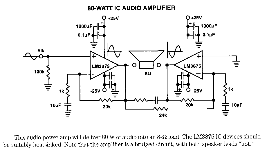

Hello,
Do you know which heatsink would best fit the LM3875 (TA11B package) of this 80W amplifier?
well, basicly you can calculate like this: if you know the power disipated on the IC, lets say P=20W. then if you have a room temperature of about 20 dergees Celsius, and you allow the IC to heat up to 80 dergrees that means that you have 60 dergrees difference. that means that the temperature coeficient(i am not sure it is called like this) of the heatsink should be mminimum 60/20=3dereees/W
usually whae you buy a heatsink you can ask abuot that.
you might find sheets of aluminium with different thickness wich you can use to build your heatsinks an they say the heat conductance of it and you can calculate the surface of the heatsink.
now, back to your problem.....i dont think that you will have more than 20-30 W disipated on the heatsink so.....
I calculated it as you told me with 30W and 60°C of temperature difference, so I've found 2°C/W and I have choosen the RAWA 208- 14 which dissipates 2.2°C/W.
Do you think it's ok?
Yes it will work. Bigger heatsink is always better.

i checked the datasheet and it says that the maximum disipation is 125W!!!!!!!!!!!!
here is the note for that: 'Note 3: For operating at case temperatures above 25°C, the device must be derated based on a 150°C maximum junction temperature and a thermal resistance of
qJC = 1.0°C/ W (junction to case). Refer to the Thermal Resistance figure in the Application Information section under Thermal Considerations.'
i dont really understand what it means(the language problems) but i think you shoud check the datasheet.
Where did you read that because on the datasheet of the LM3875 it is said that you have to apply this formula to calculate the maximum disipation: PDMAX = (VCC^2)/(2*(pi^2)*RL). I calculated it for VCC=50V and RL=4Ohm and I found PDMAX=30W...
yes, i misunderstood, it says that in any condition the disipation should not be more than 125W because it will destroy it....sorry for the confusion
