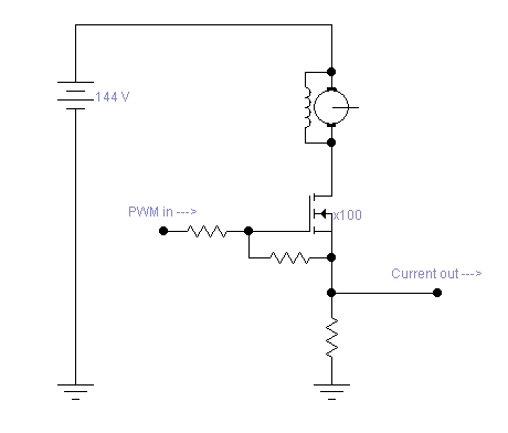

I'm building a DC motor controller. I've considered an mcu for the front end but I don't have the space in my head to learn the programing. I've searched high and low for a dedicated PWM IC and for the life of me I can't find ANY that can do 100%. They all have built-in deadtime for push-pull smps ect. I can't believe it doesn't exist. Heck, even my cordless drill can do 100%. Here's a few requirments.
Will run off +15vdc
Output capable of 0-100%
2 error inputs
5v internal ref would be a plus.
The only thing close so far is an SG3524 or SG3525 with the outputs tied but they can't do 100%. I also found the TL1451 but the outputs need pull-up resistors and I can't risk any power-on spikes at the outputs.
Any suggestions?

Can you provide more details about the application.
3v0
Typical low-side switched motor controller (see attached). The power side is already laid out. Mosfets, Diodes, Drivers, and Regulators for the PWM are in. All that's left is a 0/5v PWM from 0-100% to drive it and the ability to add some feedback for current and thermal sensing.
