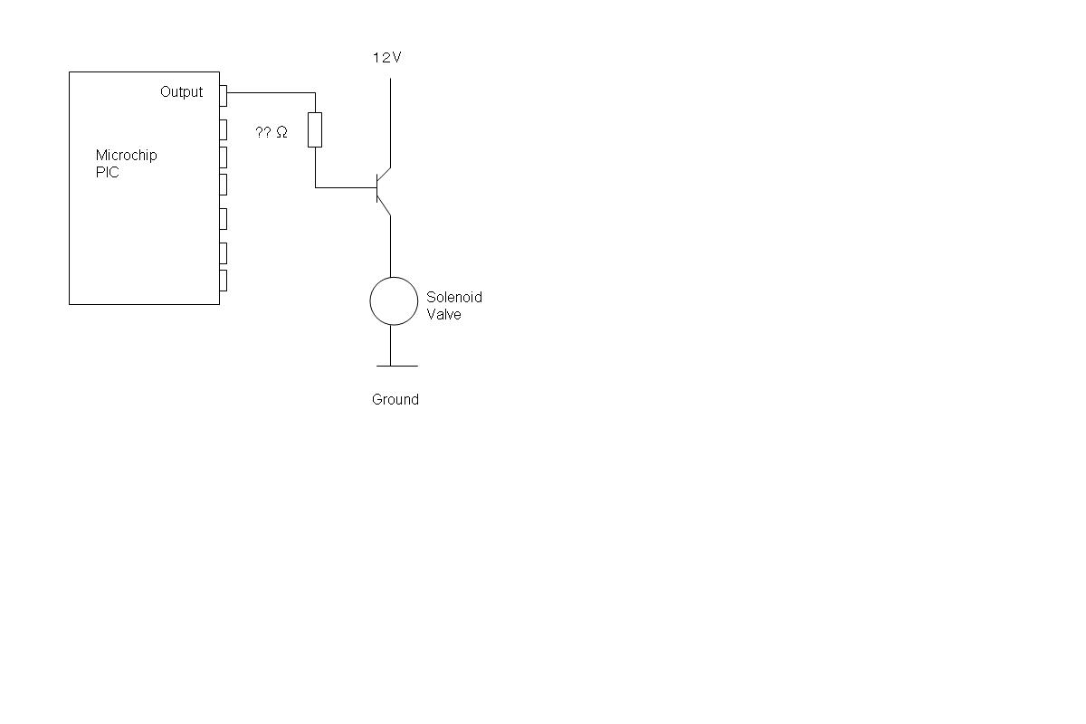

The solenoid will require a transistor or FET driver, connected between the output of the PIC and the Solenoid.
This will enable the solenoid to be powered from 12Vdc and the transistor will supply the higher current required for a typical solenoid.
What is the current rating of the solenoid.?

I am thinking something like:
but I dont know what is the appropriate value of the resistor (or if I have to use one) and even less what kind of transistor I have to use.

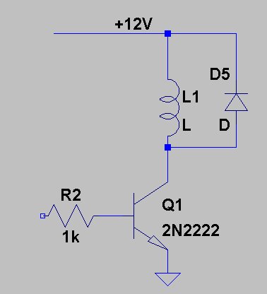

Try this.
Diode. If current is small 1N4148. If current is larger 1N4001.

Thank you. I suppose L1 refers to the solenoid valve. am i right?
I ll try that.
By the way, what for is the diode??
Kansai
With out the diode....When current is flowing through the coil (solenoid) the current wants to continue. When the transistor opens up the current tries to continue to flow. The voltage across the solenoid “kicks up” to maybe hundreds of volts, breaking the transistor. With the diode the voltage is clamped at 12 (actually 12.7) volts. The current flows back into the 12 volt supply and then stops.
Its a free wheeling diode, when transistor opens, the voltage actually reverses, but not the current. the voltage across would be 0.7 and the current would become zero gradualy. the current(energy) never flow back to the source in this case.

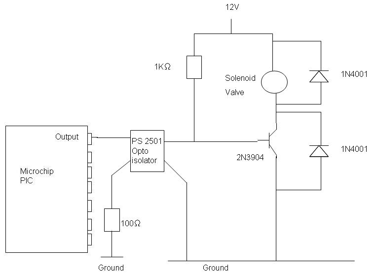

I was told I must use a opto-isolator to isolate my 5V circuit (Microcontroller) from the 12V solenoid circuit.
So in the end it came to this:
However I am not sure, it seems it does not work. I measured the voltage in both sides of the solenoid. (it must be 12V when a 5V output is applied from the PIC, no?)
Can anyone comment on this circuit? and how to check if it works or not?

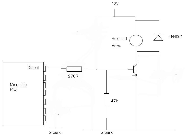

You do not need an opto-isolator.
Look at this modified circuit.
Thank you very much.
Dont I have the risk of frying my microcontroller since I am using 12V for the solenoid???
Kansai
What path do you see on the circuit that will apply 12V to the PIC pin.????
I doubt you will fry your u-controller. However, driving soleniods directly from digital electonics is usually not a good idea. I've seen too many systems driven like that that cause the digital portions to be "upset" by the transients produced by the coil switching. The free wheeling diode helps, but the very best way to do this is to use isolation and totally separate power supplies and grounds, along with the diodes to insure there is no interference between the solenoid and digital system.
You do realize that in your schematic, the opto-device is configured as an inverter, right? A 5-V signal from your u-controller will de-energize your soleniod. Also, look at the data sheet for the opto. You're operating the diode at the edge of the forward current transfer curve. Try to find some schematics that uses your part, or a similar one.

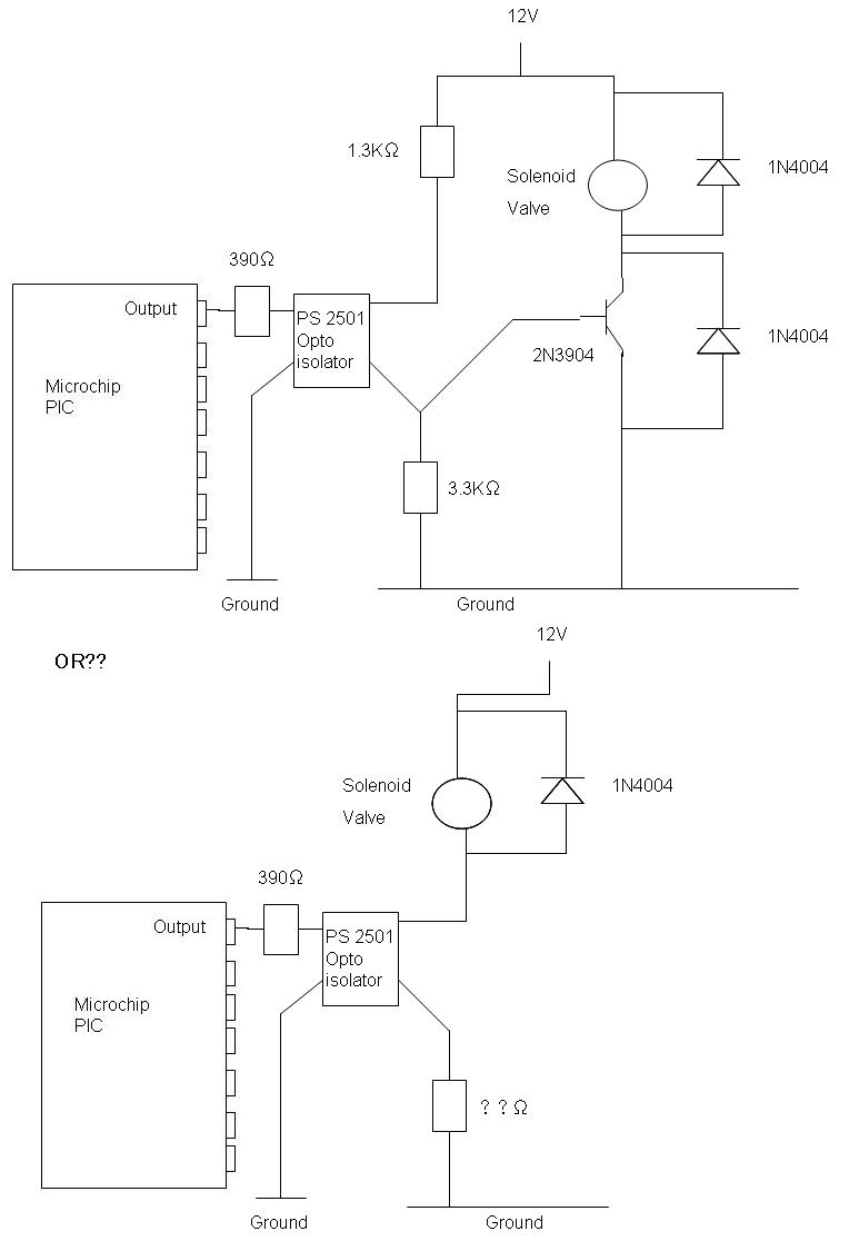

Everybody. Thank you very much for your help.I finally constructed a circuit that works. (upper side of the figure)I am just checking it for safety.
my supervisor asked me if it were possible to avoid using the transistor and just use the photocouple as switch.(lower side) Any opinion on this???
That circuit is too complex for driving that transistor/solenoid.
As I said earlier you dont need an opto-isolator from the PIC output to the transistor base.
Why does your supervisor consider that an opto-coupler is required.?
A standard opto-coupler output transistor would not be able to drive a 84mA solenoid directly.
hi, you must have been referring to the PIC book by Mazidi, am I correct?
The optoisolator is not necessary, just use a diode which goes into the base of the solenoid driver transistor. The diode is good enough to provide protection. I am referring to the circuit ericgibbs provided, just add a diode to the base series with the resistor.
Your second option in your diagram is not going to work, the internal impedance of a phototransistor will limit the current for the solenoid to function. The output current of a phototransistor barely turns on an LED with a Vcc of 9V.
I would leave the circuit as it is. Why mess with something that's working? I would also leave the opto in.
The opto coupler absolute maximum current is 50mA, the solenoid draws 84mA. Operating beyond its ratings is guaranteed trouble.
