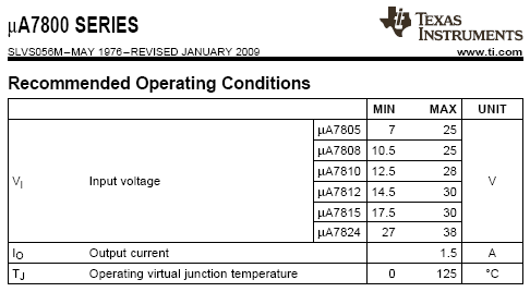

The max input for a uA7805 is 30V but a max of 25V is recommended by Texas Instruments.
It reduces its max output current when it has more than 20V input.

This is from the latest datasheet for Texas Instruments uA7800 series regulators:
