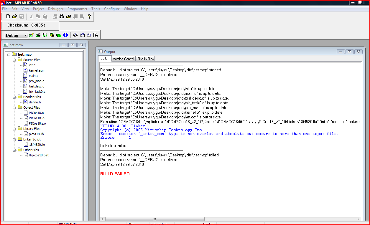

Hi all,
I'm new to mplab and when I try to build a project that I downloaded from PICOS's page I get the following error:
Error - section '_entry_scn' type is non-overlay and absolute but occurs in more than one input file.
Errors : 1
Here's my linker file:

Can anybody please help? Thanx in advance.
That file is just one small part of the main program and will not build on its own.
Looked at that picos site - any particular reason you chose it ?
Have a look at the Sticky post at the top of this forum, it list many good beginner tutorials in C and Assembler and covers all the starter hardware such as lcds etc.
This is for a course & assignment. I'm not a big fan of PicOS also :eek: I have dowloaded picOS from PICOS18 and under MyApps there's a first project. I need to build it but I can't . It has .c files, .asm files and other stuff. It looks like in the attached file.
