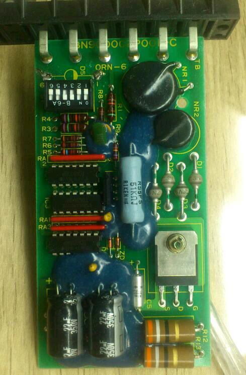

hi everybody
i have problem with knowing this diode (in attached, D5). what kind of diodes? schottky? printed code in its body is j 8j i cant understand this.it used in power supply 110 v ac to DC(measured 150 v dc) for energize an air circuit breaker. this diode use inverse in output to damp spike voltage that create when voltage will be falling (off breaker command). now this diode was damage and i want to replace with another diode.now i can't identify this diode for find same type. i don't have schematic. sorry for my Sentences, English is not my first language.
thank u for your help

It is a high voltage silicon power diode. A Schottky diode is for low voltages.
A 1N4007 is available everywhere and is rated for 1000V. Its max allowed current is 30A for 8.3ms.
thanks for your reply
how i can understand specific parameters for this diode? 30A @ 8.3 ms for 1n4007, but what about my damaged diode?
Without the original part number, you never will know the exact specs of the original diode. But the nature of the application lets us make some reasonable assumptions and recommend a contemporary part that almost certainly will work. The 1N4000 series of diodes is very common in circuits such as yours. It is rated for 1 A continuous RMS or DC current, at voltages from 50 to 1000 V. The capacitors on board are rated for 350 V, and it always is a good idea to use diodes that are rated for at least twice the circuit voltage. Since you haven't posted the schematic, we assume the peak circuit voltage is 350 V. A 1000 V 1N4007 should do well.

Hmm, looks to be a Philips design, tho without the numbers, the exact part is not too probable. Those are for switching but tend to have a low forward drop by design. Typical 500mv. Far as I can gesture.

As far as I read it, this is a diode to clamp the reverse coil voltage when the solenoid is powered off.

The coil collapse voltage is never higher than 0.7V, since that is what the diode is there for, to clamp it. The voltage rating for the diode depends solely on the power supply voltage of the relay coil.
As I said before, you have to give a REASON . . . a specific reason . . . why a high voltage or high current or fast-acting, diode is required.
That's why I specify 1N4004 as it is a general purpose diode and requires no thinking. It is silly to specify 1N4001 (50v) or 1N4002 as this will require stocking a wide range of un-necessary components.

thank u every one, i found similar type diode its ultra-fast avalanche sinterglass diode , i can't replace 1n4007 because : 1-Vr=1.6 kv 2-Trr=75ns VS 1kv and 8.3 ms in 1n4007
my reverse voltage is 150 vdc (not 350 v) but Trr is important.my forward voltage depended di/dt. i think UF4007 is my ideal. Though i can't understand what means green in Cathode
sign?
