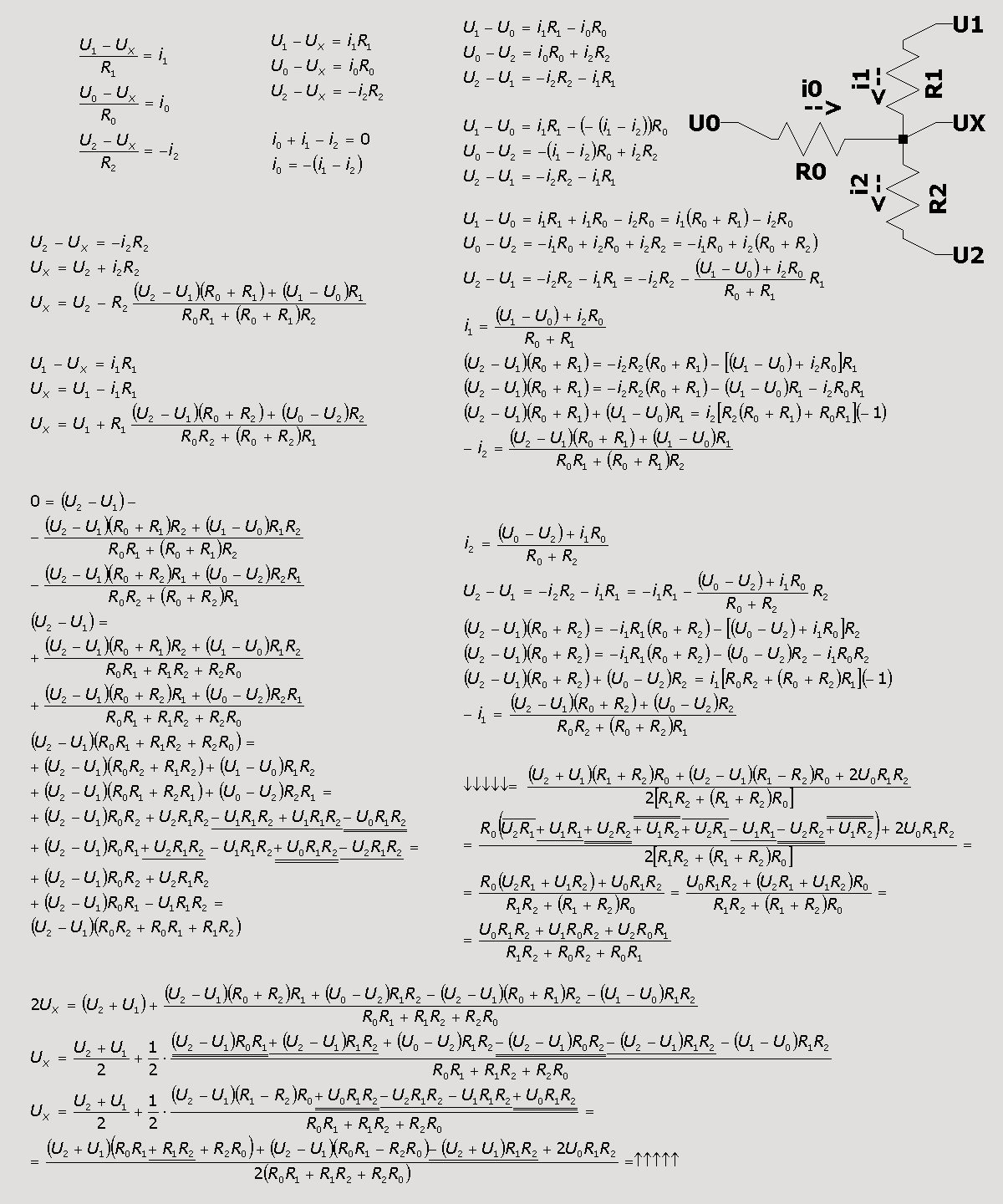

this might be helpful (not verified to be typo free) ← this might leave wrong impression about the actually required - so i made it to "half a way"
IMG_9955.gif → bug fix. : Ux = Ku·(U2 - U1) + OpAmp's Internal Ground (= usually (Vcc + Vee) / 2 , on the attached schm. OAiG =apx. Us /2)
here we don't have neg feedback so the hysterresis assumes the OUTP voltage being either
  1. Zero + α -- occurs when +INP < -INP
  2. Vs - ß -- occurs when +INP > -INP
    where α and ß are Op Amp's offsets from Neg and Pos rail respectively
  • -- so we have to consider only the "helpful formula" where it sets the +INP when the OUTP has fixed eigther near the + or - rail
    + . . . usually the inverting inp ( -IN ) is used for reference voltage that sets the hysterresis center - - if we use it for input signal we vary that center - - PS! - - that most likely sets your hysterresis to be input dependent !!!
  • update : in simple form it actually goes like :
    1. +INP < -INP output = Neg.Rail so the 6M8 Ω goes in parallel with lower part of the voltage divider at +INP
    2. +INP > -INP output = Pos.Rail so the 6M8 Ω goes in parallel with higher part of the voltage divider at +INP
