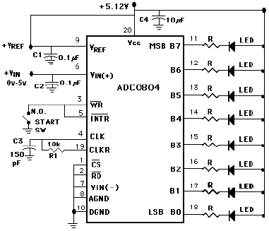

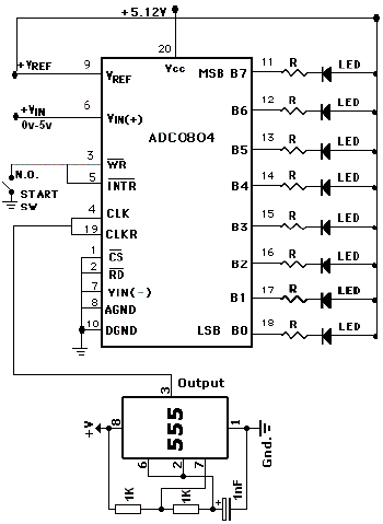

why my adc 0804 only shows 4 LEDs turn on (B0,B1,B2,B3) 11110000,
and there is no change when i set the input (Vin) between 0v-5v ?
i've try with R and C for clock, and with 555 multivibrator.

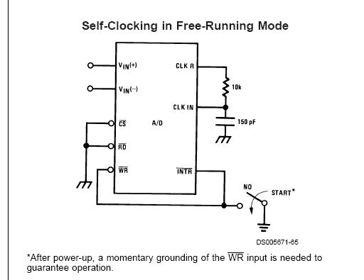

I'm not sure but I think that you must give some pulse to RD pin
to start the convertion(not to tie it to the ground).Read the PDF file of your ADC for details about the RD-WR operation.
