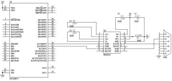

i'm trying to built an ADC circuit by using PIC16F877A+MAX232+RS232. can anyone provide me the circuit diagram(schematic) of the ADC?

For Serial communication just follow thw cicuit in attachment and follow the hitech pic code, it will return a value what is received before. Sending ADC value to System not a big thing just read ADC part datasheet and simply follow it.

that code will work but expects a clock rate of 4Mhz for a 9.6K baudrate. look in the tables in the 877 datasheet USART section for your clock rate and desired baudrate. also, you may need an initial delay to let your max232's charge pump to get up to voltage.

This code will work for all Oscillators, without restriction b'coz there is no need to have an delay instead the code simply check whether the previous byte has been sent or not by checking the TXIF bit, if the TXIF bit is 1 then we can assume the previous byte has been sent and Transmit register TXREG is now ready to send next byte. IIIly if RCIF is 1 then we can assume there is a byte in RCREG.
No it won't! - it has EXACTLY the same restrictions as other methods, that it's set to a particular baud rate and a particular oscillator frequency. Where as with software RS232 you need to alter the delay time, in this case you need to alter the register values (which effectively set the delay time). Same thing really - but if you've got the hardware UART it's worth using, assuming the pin isn't being used elsewhere?.
Yes ofcourse u r correct but what i am trying to say is :
For the same value ie decimal 25 we can get:
9600 baud rate at 16 MHz when brgh=0
9600 baud rate at 4 MHz when brgh=1
2400 baud rate at 4 MHz when brgh=0
so just changing the brgh and spbrg values is enough to work in different baudrates. Thats the thing i want to tell.
