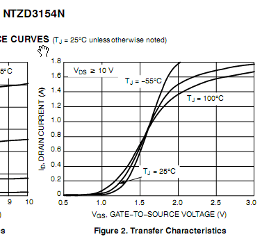

The best guide is to look at the Vgs gate graph on the datasheet for the MOSFET.
It may start conduction at 'low' Vgs but the Ids current will be low, until the Vgs increases according the graph.

Look at this dual FET

Let me see if i got it.
The data sheet says: Vgss -Gate to source voltage- = +-20v
So to be a logic level one the Gate to source voltage needs to be 5v?
Am i right?

Look at my edit with the images.
Although this too low a current for your application, the Vgs curve threshold/conduction curve will be a guide to choosing a suitable FET

Here in the document i attached in page 3/9 in figure 2 it shows a similar graph.

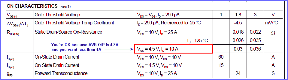

If for my proyect i just need 3 amps, and have a current of 5v to drive the mosfet this mosfet will be ok, or it will present some kind of problem?

Yes, it will do nicely. I have marked the piece of information on the datasheet that one need to check if it is OK for one's application. The part is NOT suitable if one wants 10A or more but it is good for 5A or less so no problem in your application.
