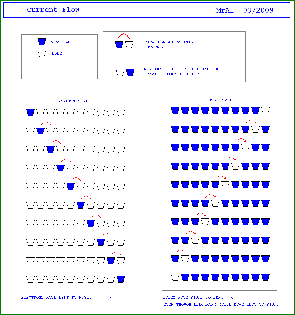

Hello there,
It is not correct physically to think of electrons as flowing from the
positive terminal of the battery, through the circuit, and back to the
negative terminal because that is not the way it works in reality.
It is however correct to think of the 'holes' as flowing in this way
because the hole flow is opposite to the electron flow as shown in
the accompanying diagram.
The convention of current flowing from positive, through the circuit,
and back to the negative has been accepted however not only because
it was invented a long time ago but because it simplifies a lot of
analysis by eliminating the minus sign (-) that would have to be
present in a lot of formulas where you could leave it out if you assume
'conventional' current flow (positive to negative).
For example, Ohms Law:
R=V/I
if we had negative current flow would read:
R=V/(-I), or R=-V/I
either of which makes things more difficult.
This is also true in other areas such as control theory and design.
Using the convention of current flow from positive to negative results
in simpler formulas.
In physics electron flow results in simpler formulas rather than 'conventional'
current flow so it really depends on what area we are working in.
What you are looking for i think is how to relate the various parts you
find to the circuits and how they connect together properly, and to
understand more about this so that you can look at a schematic and
understand how and why the component is connected the way it is,
and also to be able to duplicate this yourself with an actual circuit
breadboard you build up at home.
To do this you really need to take one type of component at a time
and look at it carefully, and fully understand it before moving to the
next.
Start with a resistor, which im sure you know is not polarized, so you
can connect it into the circuit either way you want to.
A diode however does have a polarity, so you have to be careful how
you connect that into a circuit. Well, if you look at the diode you
will see that it looks a lot like an arrowhead. The arrowhead points
in the direction of *conventional current flow* (positive to negative)
so that in order to get the diode to conduct you have to connect
the anode (tail of the arrowhead) to the positive terminal of a battery
and the cathode (tip of the arrowhead) to the negative terminal of
a battery (though a resistor to limit current). The current would then
flow from the positive terminal of the battery, to the anode of the
diode, through the diode to the cathode, then through the resistor
and finally back to the negative terminal of the battery. Again,
this is 'conventional' current flow and is more like what is called
'hole' flow than actual electron flow, but nonetheless works out in
practice when thinking about it in this manner.
If we wanted to look at the diode in terms of true electron flow, we would
simply start at the negative terminal of the battery, move to the
resistor, through the resistor, then to the cathode of the diode and
through the diode to the anode, then through the wire back to the
positive terminal of the battery. The direction we choose is rather
arbitrary unless we are reading material that already assumes a type
of current flow, in which case we then are forced to adapt to whatever
that author chose to use at the time of writing. It's a good idea then
to know both ways of looking at a circuit.
When connecting one circuit to another or a battery to a circuit,
usually there is only one convention however. That is to 'match' up
the polarities to one another. Thus, to connect a battery to a circuit
that has plus (+) and minus (-) written or labeled on it, we would
connect the positive terminal of the battery to the plus (+) and the
negative terminal of the battery to the minus (-).
How we connect other things depend on how we want to connect them
together, such as in series or parallel. You probably need to look at these
kinds of basic circuit connections also before anything else.
Here is a diagram of current flow looking at it from the point of view
of an electron or of a hole...

This is probably the worst legacy issue I hate about electronics, luckily it doesn't matter most of the time until you get into semiconductor physics.
It also was important (and still may be for the few people that still use them) in understanding the operation of a vacuum tube. Electrons boil off the hot cathode, fly through the tube vacuum, and are collected by the positive polarity plate. It doesn't make much physical sense if you try to talk about positive charges leaving the plate and going to the cathode.
You mean holes can't flow in a vacuum? If electrons can flow in a vacuum why can't those new fangled holes also. ;)
