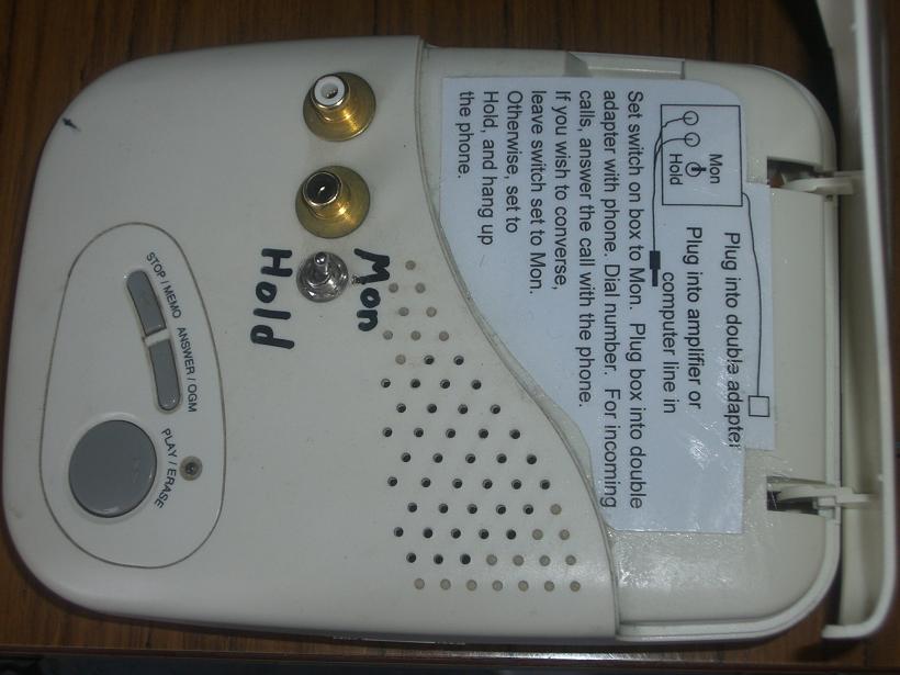

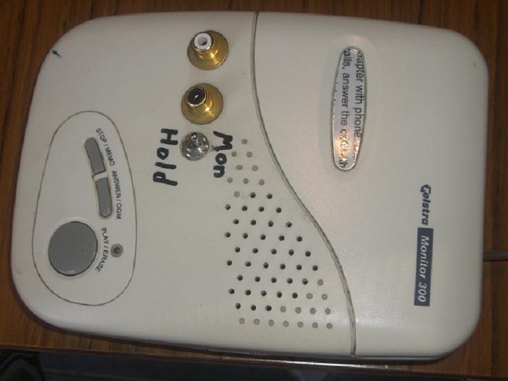

I modified an old answering machine.
I used the transformer, the RJ12 connector, the PCB and the case.
I inserted 2 RCA sockets and a toggle switch in the case and removed some of the components from around the tranformer so I could mount the new components in the vacated holes together with some wire jumpers as necessary since the tracks were not designed for this purpose.
I left most of the parts on the PCB but ensured they were isolated from the monitor circuit.
The toggle switch provides 2 options. Monitor and Hold.
In the Hold mode, a loop is applied to the line to hold the call so the phone can be hung up. In the monitor mode, the loop is not applied and the call is held by the phone.

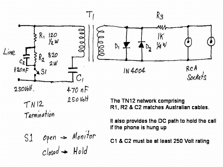

I don't have the circuit, so I'll borrow the unit from my daughter and copy it and post it.
Here is the circuit and photos.
The instructions can be read in one of the photos.
The TN12 termination matches Australian cables. A different impedance may be required oversaes.
T1 and C1 were in the Answering Machine, I added the other components into holes from which components were removed. I cut a few tracks and inserted some wire jumpers as necessary.
