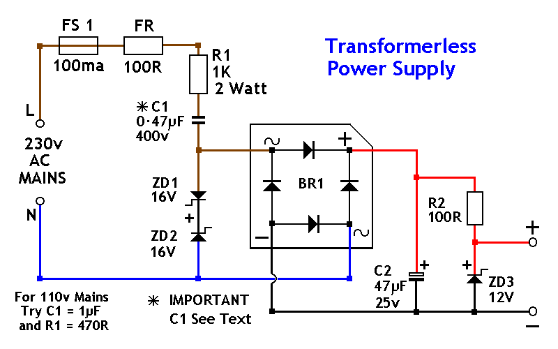

thank you very much for your help gentlemen. if i use the circuit given below, which is transformer less power supply. will the RF get coupled into the mains? i mean without feeding the rf output via a cap. into the mains?i think this way,because there is no choke used to stop the rf from getting coupled into mains. i will use a cap to avoid the 60hz hum. will it work?
or will i have to feed the rf from the output to the mains through a high voltage capacitor? please help.

I like Mike's idea of driving RF from Neutral to GND.
So why none of the commercial unites do that?
One of the points if the transmitter is to not send RF into the air. Only have it differently on the power line. I believe Line and Neutral balance out well when differently driven and thus do not radiate much RF.
Because neutral and ground are tied to the same point at the junction box in many situations. Not sure if it'd work.
