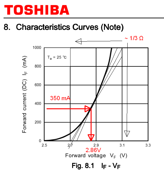

Good 1W LEDs are typically 350 mA at 2.9V = 1 Watt
The rest will have higher tolerance on Vf ( e.g. 3.4)
Running a 3V LED from a 12V supply with a series regulator and series resistor is going to be 3/12 or 25% efficient alone.
Using strings of 4 gets you almost 12V with a 2.9V LED. If you have these LEDs and a good 12.0V supply , you can regulate the current with a measured power Resistor that ends up being anywhere from 0 to 0.5 Ohm. Otherwise a regulated LED driver with constant current (CC) source up to 350mA is recommended.

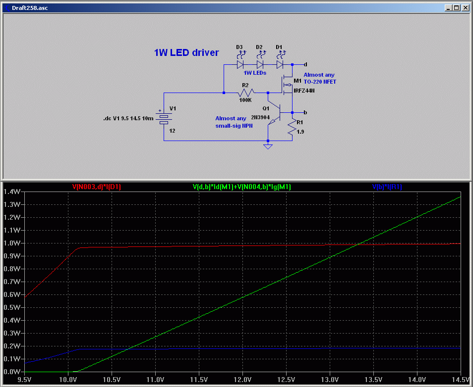

I like this better than using the LM317.
Note the power in one of the LEDs (red trace) as the battery voltage varies from 9.5V to 14.5V (x-axis). It begins regulating when battery voltage >10.2V.
Note the power wasted in M1 (green trace) and R1 (blue trace). M1 will have to be on a heat-sink if it is dissipating more than about 3/4W.
MikeL circuit is very stable and well regulated to just about any common device and is a perfect solution for unregulated voltages in this range such as a car, where efficiency is not a major concern, only cost, performance and reliability.
The 0.6V Vbe drop is a small price for current regulation and the additional MOSFET loss used as a linear regulator in this very good classic CC stable regulator design is roughly equal to one 1/2 LED at 14.5V or 67% efficiency.

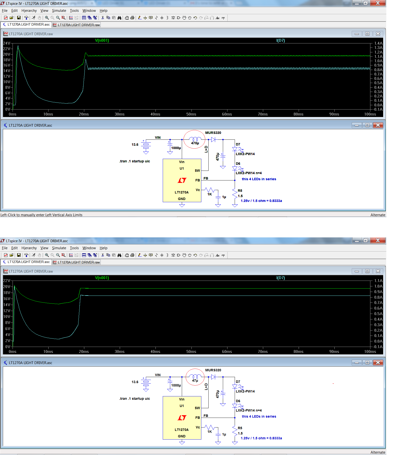

This is a design I've used many times, it will work with 4 or more LEDs in series,Untitled.png
After looking harder at Post #6 This is virtually the same, but set up for 833 ma, the use of a zener would not be practical, it would have to be able to absorb all the power that the several LEDs had been using. Also, the LT1270 is rated at 8 amps and the LT1270A is rated at 10 amps.

Hi Mike,
Such the simplest and clever circuit always attracts me! So useful even for charging Ni-Cad or lead-acid batteries from this nice constant current source!
I know that PN junction of the NPN making the base of the transistor regulated at 0.6V so the resistor only will pass 0.6V/1.9R= 0.3A constant current. Here main power dissipation is in the resistor but the transistor junction is making the base voltage regulated always, so doesn't it dissipate huge power same as resistor? The voltage regulation made me amazing! Always I get fail to understand the operation of transistor in such condition.
Willen, look at the plots in my simulation of post #7. I show the power dissipation in three of the parts. The power dissipation in the NPN is a few uW.
Base current is only nA. Collector current is uA. Vbe is ~0.65V.
I think collector current is limited by 100k (12V/100k=120uA) and same the gate current. Otherwise it would dissipate huge power maybe. Nice trick. :) Using almost no current, the Base is limiting voltage, amazing to me still!

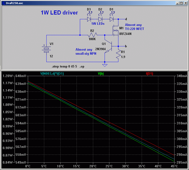

Here is the dirty little secret of the LED driver I posted in #7: At least it doesn't make the LED(s) go int0 thermal runaway...
It seems that if we placed a LED and the NPN touching each another (to transfer heat from LED to transistor). When temperature go high, the base goes low and power limited in synchronous way. :) But seems not more practical.
I also have a little secret method of preventing thermal runaway with some engineering calculations.
If you designed or know the thermal resistance [°C/W] and know the temperature coefficient of the LED [mV/°C] and the Pd [W] max power rating at some target temp like 85°C , I have developed a method that works for finding the critical minimum series resistance where thermal runaway can be prevented.
It works by adding a small external Rs, which is near the internal LED ESR. It depends on Pd Max, expect Tj rise, thermal resistance of heatsink and and by adding Rs to the string , if current rises due to self heating and reduced junction voltage the external voltage drop on the external series resistance or cable resistance must have at least the same voltage drop as expected from the rise in temp to eliminate the cause of thermal runaway. This added resistance reduces the NTC effect since any current rise would induce more voltage drop in the external series resistance. Normally one sees very large values which are quite inefficient, whereas I have discovered to avoid the critical point of runaway by adding less than an Ohm in series with the string of LEDs.
NTC of White Power LEDs = -3.4 mV/°C
The 1.9Ω is the current sense, which is amplified at a threshold of 650mV but does not limit the current.
The collector drives the 100k resistor pullup bias to drive the FET , which limits the series LED current.
Since the Vbe diode characteristic, is that of a negative temp coeffic. or NTC, the threshold is shown here to reduce by -1.5mV/°C which if it were thermally connected to a LED metal clad PCB would serve to reduce the current a little bit as the LED's generate heat.

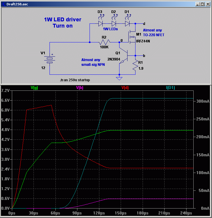

Can any one explain how this circuit works?
If the NPN is initially off, the 100K resistor (rather slowly) begins charging the gate capacitance of the NFET. As the gate voltage [V(g) green trace] reaches the threshold voltage of the NFET, it begins turning on. The current through the LEDs, the NFET, and R1 [I(D1) blue trace] starts increasing.
As the LED current increases, the voltage drop across R1 [V(b) violet trace] increases toward the normal Vbe of ~0.6V, at which point the NPN begins turning on, drawing current through the 100K, clamping the gate voltage V(g) to the point where the NFET has substantial voltage from drain to source, thereby regulating the current though the LEDs and R1.
The circuit stabilizes with I=Vbe/R1. In this example, I = 0.6/1.9 ≈ 0.3A
