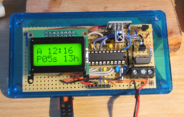

My watering system does not rely on soil moisture measurement , as it tends to be unreliable ,( probes disappear ! ) and most plants don't need a constant degree of wetness, they do need good drainage so if you set up a timer to water regularly ( in daytime ) and then adjust pump and frequency for conditions, if plants are inside then a relative humidity / temperature sensor can aid automation.
Edit add pic.
This shows pump will run 5 sec at 13:00 hrs , all runs of a 12v battery with small solar panel.

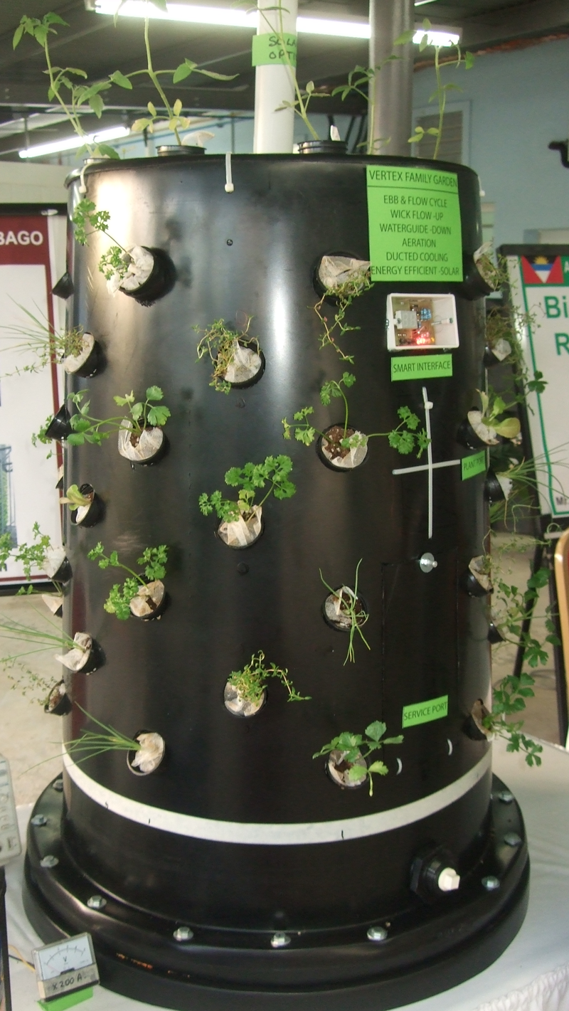

Well Clarkdale, I have an extra unit built/tested already. If you like I can send it to you for the cost of shipping. It fits in a 4"x 2" electrical can as its housing. Shipping from the Caribbean to the U.S.A. (I presume u are there?) will be around $12 via Paypal.
Here is the Operations manual for it.
Also a pic of it installed in an inverted 55 gallon potable water tank housing as an indoor/outdoor hydro. farming unit, 30" diameter floor space.. That unit grows around 50+ plants of the green leafy type.
Thanks for your kind offer, but i think i am gonna wait for a while before deciding which one to buy. I may or may not buy the timer, it may not worth it for the plants i have right now, but because of the timer i might actually upgrade my pots into a small garden in future...
